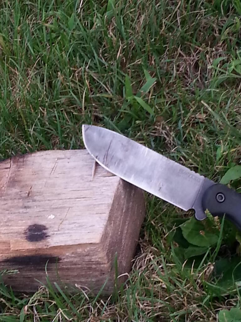

Ok so I snapped about a 1/2 inch right off the tip of my BK16. I was wondering if you guys had any recommendations for someone who might be able to do a repair job on it. Maybe turn it into a spear point of some sort?
If the knife is used as a hunting knife, you could round out the top of the break to assist in skinning.
As far as who to go to, you can do it yourself with a file or a dremel, just remember to not overt heat it with the dremel, take your time. Finish up with sand paper to preferred finish.

I was using the knife outside of what it should be used for, imo. I have used this knife for battoning in the past as you can tell by the vertical marks in the patina, but the tip was broken as I was attempting to pry apart a piece of half split seasoned birch.
Patrick - you might give Dexwithers a shout. He's done some impressive mods, regrinds etc. w/ his BK16s. He has an online store now and I think he offers mods as a service.
If not Dex, maybe just go at it with a file and see how it turns out. Just be sure to clamp the blade in a vise very securely to avoid a trip to the E.R.
