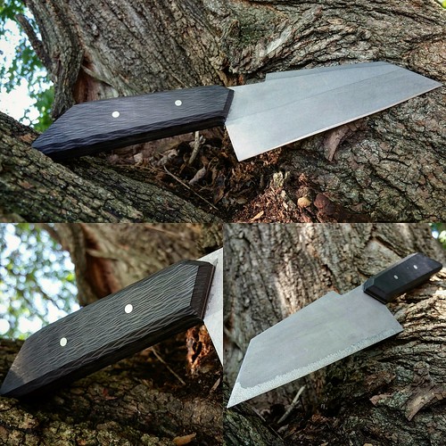

Cryo treatment would have no impact on edge toughness or retention on standard ti. To create a working cutting edge out of ti you need to carbidize it. I have been making knives out of titanium for a little over a year, others have been doing it longer. Adding a layer of tungsten carbide to the edge gives it a HRC of 71 on the carbide side, combined with the softer titanium makes for a nice cutting edge that is easy to maintain and completely corrosion resistant. Not sure how it wouold,stack up on a hatchet as you would be using a lot more force than a regular knifeblade...but im certain it would work out ok.
Whats a thread without pics right...you can see the carbide added to the blade in the pics:
