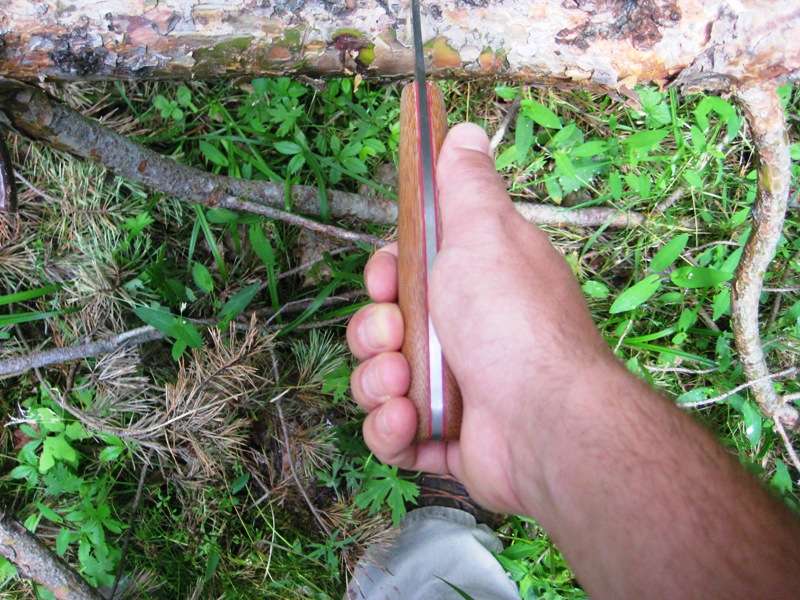

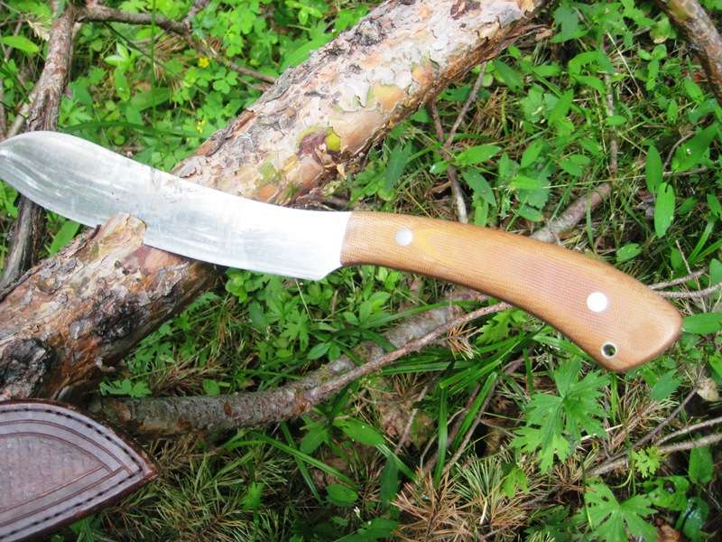

I've been giving my favorite chopper a good workout lately and it's been performing admirably, hacking through thick saplings and remaining sharp. The other day, however, I managed to loosen the handle on one side and a small chunk of the wood next to a pin has broken off. The handle is now just slightly loose and makes hollow slapping noise when you rap on it with a knuckle. The knife is still usable but I'm starting to think about re-handling it down the road. I considered doing it myself but I think I'd rather start with a smaller, cheaper, less-favorite knife before trying anything on this one. I would like suggestions from you guys though, as far as which handle material to go with, which maker or manufacturer to send it to, etc. I have a knife that's been re-handled by BRKT and I think they did a great job but cost and turnaround are also factors. I just got my first paycheck yesterday after three months of unemployement so I'm almost dirt broke. So who does a good job without breaking the bank? Which handle material would you go with? Should I just stop whining and re-handle it myself with homemade denim micarta or moose bone? As always, your opinions will be greatly appreciated. Thanks.
Here's the knife in question (top one):

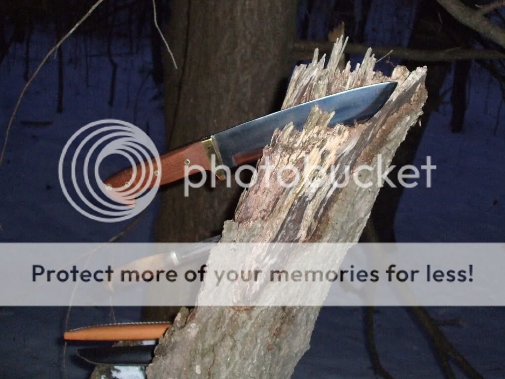

It will be very difficult to find a better price and better craftsmanship than Dennis Jensen. He has rehandled a couple of knives for me and his work should costs alot more than he charges. He goes by DJJ on here. He will even contour it for you.
Here's 1 he did.
