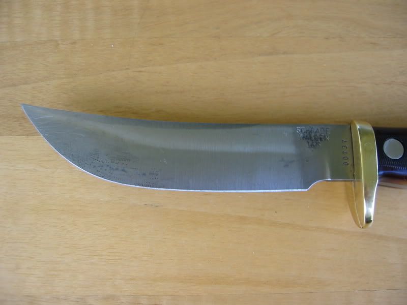

All of the Shikaris are Schrade Waldens with the tangstamps on the left side of the blade (SCHRADE over WALDEN over 165). Also, all have relatively low serial numbers. There are regular production Old Timers mingled in with those numbers, so, as mentioned, there was likely not a dedicated number series just for these Shikari shielded knives.

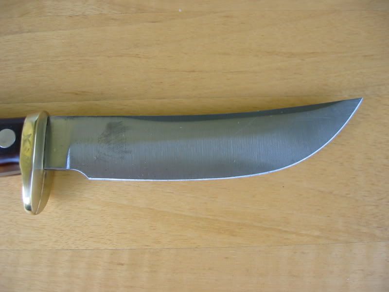

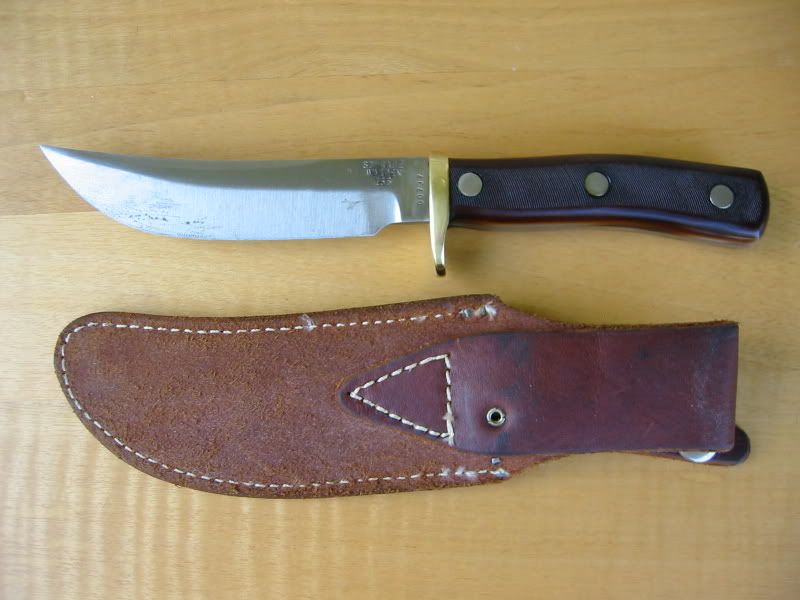

Here is the regular production 165OT from that period (second style sheath).
Some time after the first 19-20,000 production knives were made, the tang stamps changed to blade right, then serializing ceased, then the name changed from Schrade Walden to Schrade. #20735 is the highest number I've seen serialized so far though they may have gone higher.
