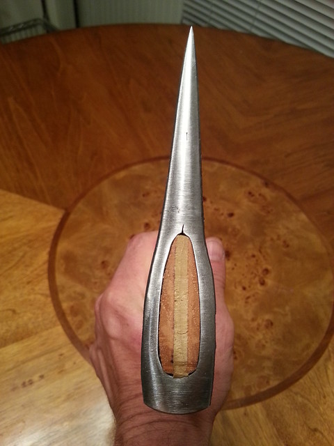

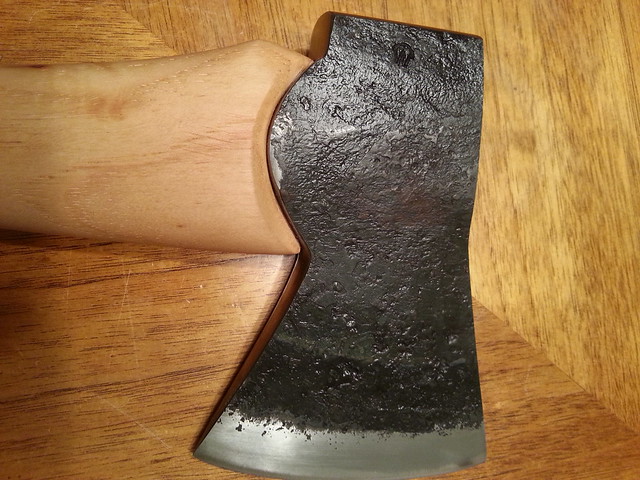

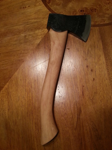

1#13oz head on a 16" kiln dried hickory handle. I have been buying hickory planks from a hardwood supply store and shaping my handle from them.
You can see some of the weld but it will not affect the axes performance.
Any comments, critiques or advice is welcomed.

Thanks gents. Per my usual this is a mild steel bodied axe hand forged with a 5160 carbon steel bit set in when its wraped and welded.
Jon, I use a belt grinder for the finished portions. I start with 36 grit then move up to 120 prior to heat treating it. After heat treat its just clean up with 120-360 grit. The handle I use a hand saw and small camp axe until its rough shaped. Then I go to the belt grinder again and hand finish.
I don't think it will affect the performance either. But, do you think tig welding the weld line before heat treating would show up after ground ? Just blending with the torch- no filler.
It probably would camouflage the weld. I have seen a couple of really old axes that showed in much the same manor. Its pretty hard to get them perfect every time. Is the weld showing the small amount it does problematic if its just cosmetic? To cover it with a modern weld takes away from it on a forge finished piece to me. But I definitely have my take on things and want to hear others take on it. Perhaps I would feel different if I saw the same piece from another perspective. Thanks.

Maybe I do see things differently lol. To me- If I had to explain to everyone who saw that weld flaw that it will not affect the performance- it would bug the shit out of me. I'm no expert and don't believe every forge weld will be perfect every time.
I don't see the fusing of a seam as Camouflage. The area in question has been ground so that doesn't take away from the forge finish in my mind.

By pointing it out I didn't intend for it to be seen as a flaw but as evidence of the constrution method. I probably should have worded it different. To me its a tool. If I thought it were a flaw I wouldn't gift it or show it. I can see how it might be a bother to some. I do try to make every weld hide, but the reality is some don't show until they are hardened. The one at the front of the eye could have been filed out but I didn't see the need. If the weld showed along the bit on the cutting-edge I would feel that is a flaw.
I may try to stick weld one to hide the weld one in the future. Thanks for giving me your perspective. I do appreciate it.
