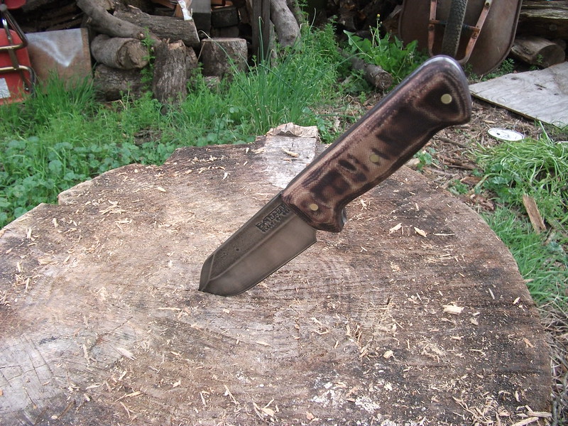

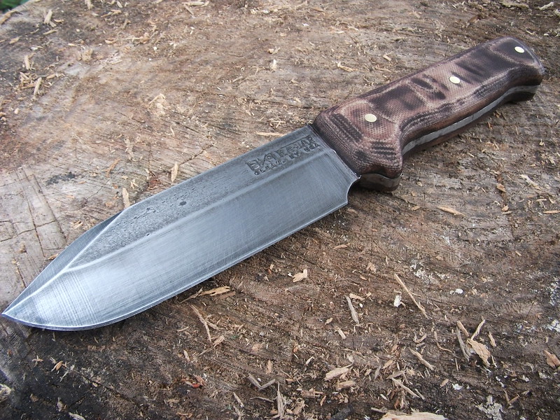

This is my first time working with Micarta, I kind of wanted the handle to have an old style look to it, kind of like an Old Hickory knife that I ones saw that was all beat up and scared.

Dang, thats quite a transformation! Lets see if I'm catching all the mods
1) Choiled
2) De-Ramped
2) De-Pommeled
3) Custom Scales
and is it slightly patinaed or etched on the flats? Or is that just the way it has aged?
Dang....I bet that is about a perfect woods-knife now! And they are pretty much perfect factory, hard to improve on the 10, but I think you have successfully managed it!

Yup you got the mods right, slight etch on the flat. The balance and feel is perfect right now, the balance point is right in between the choil and the index finger so its blade heavy in the normal grip, and then handle heavy when you choke up and use the choil.
My aim was really to make it more of a bushcraft style knife.

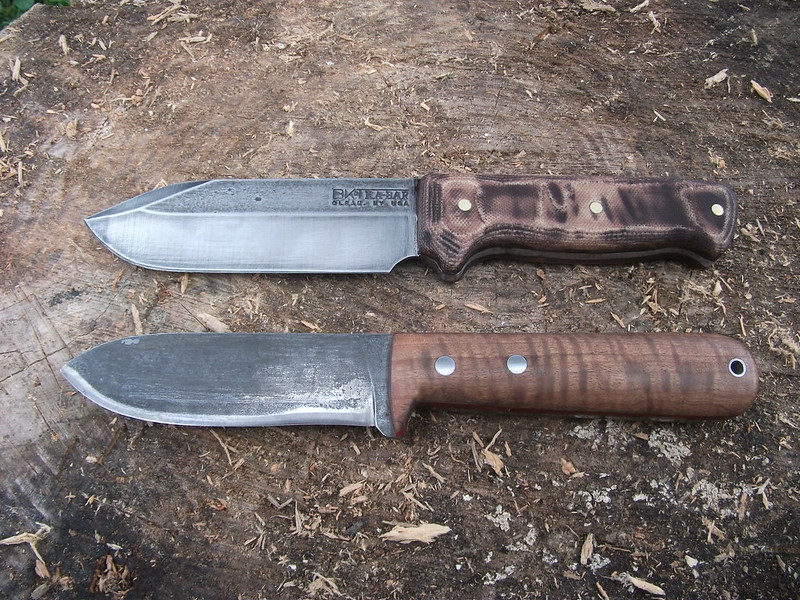

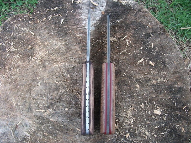

What is the other knife in the picture? Did you make that also?
That is a KFU .
