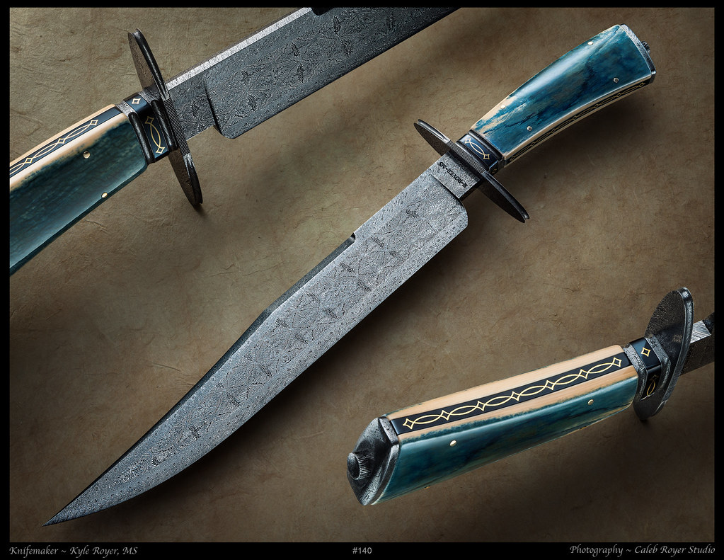

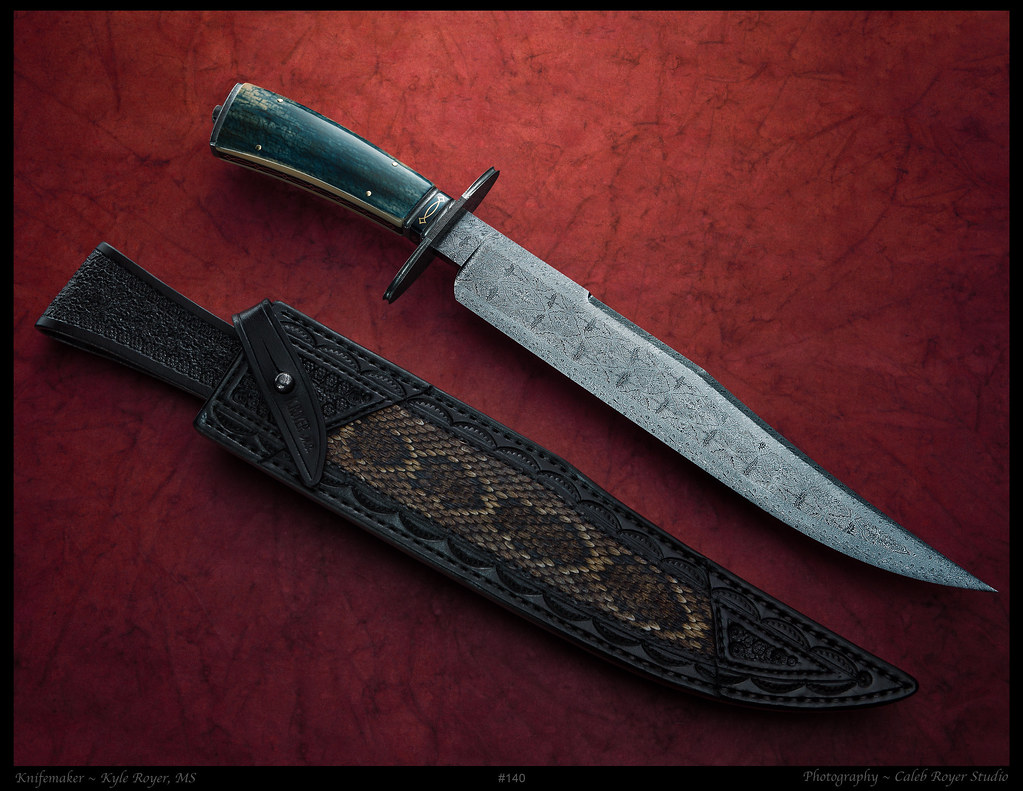

Hello everyone!
Yes, I'm still making knives. :) I have just been so busy with custom orders that I've not spent due time posting them on here as I should have been. So here's a fancy one I just recently finished up for a collector up in Northern IL.
My brother, Caleb of Caleb Royer Studio, did all the great photo shooting on this one! All I can say is that he's got the touch for it. :D
Specs to follow,
The 11 inch blade is forged from 1080 and 15N20 damascus that has a tile mosaic core with mosaics of the same pattern on the outside perimeter of the blade, only instead of tile mosaic the outside bars are twisted mosaic. The handle is of some really nice blue/green fossil mammoth ivory with four domed gold, 18K pins. All the gold inlay in the blued steel fittings is also 18K. The handle is a take-down for future maintenance and clean up if it ever needs be done. The rest of the fittings are of the same mosaic damascus that the blade was forged from. The guard was grooved and coined, the front spacers were also grooved and the pommel nut was coined. The spine of the blade is crested. Overall length is right around 16 inches. I made the sheath for it as well and it has lots of tooling and a rattlesnake skin overlay. I think that’s about it. Let me know what you all think. :)
Thanks for looking.
Astounding photos of a knife that words cannot describe the beauty.
that's crazy good.
Really, really beatiful work Kyle! Someone in northern IL is very lucky and is going to be very happy! It's been a while since I liked a knife as much as I like that one.
Always a pleasure and a feast for the eyes seeing new stuff from you, Kyle !
What a Bowie and sheath, :thumbup: on Caleb's images !!
Doug
Outstanding Bowie and Sheath. Beautiful ivory as well.
I really like your sheaths, surprised more collectors don't have you supply a sheath with the knives you make for them.
Extraordinary knife and sheath all around. The touches of gold work and that mammoth are outstanding.
That Damascus blade on this one, though; I don't think I've ever seen a finer. Fantastic, Kyle!
John
WOW!! what a great looking knife. The damascus is fantastic and I like the colors on the handle they blend perfectly.
Steve
Kyle this knife is a true work of art I just love the way it all flows together very very Nice.
OUTSTANDING on all levels Kyle. Love the long clip, blade profile, and the damascus and inlay look excellent. That blue mammoth is AWESOME!
GREAT pics by Caleb as usual.
Been wondering where you've been. Haven't seen any posts for a while.
Peter
