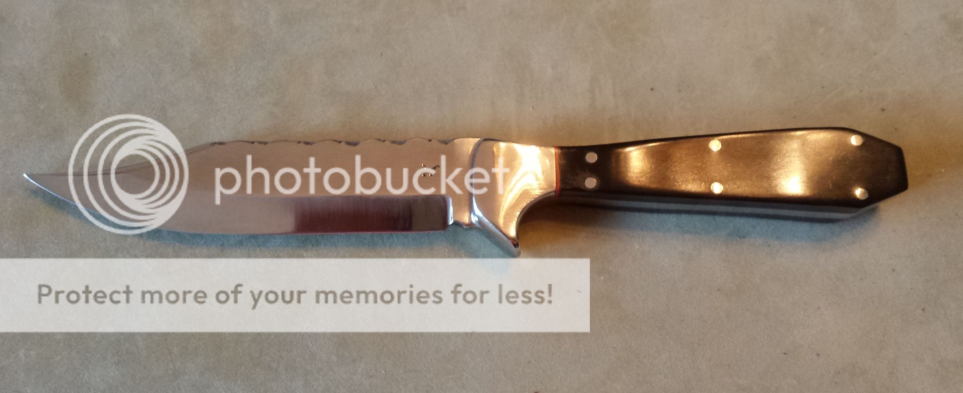

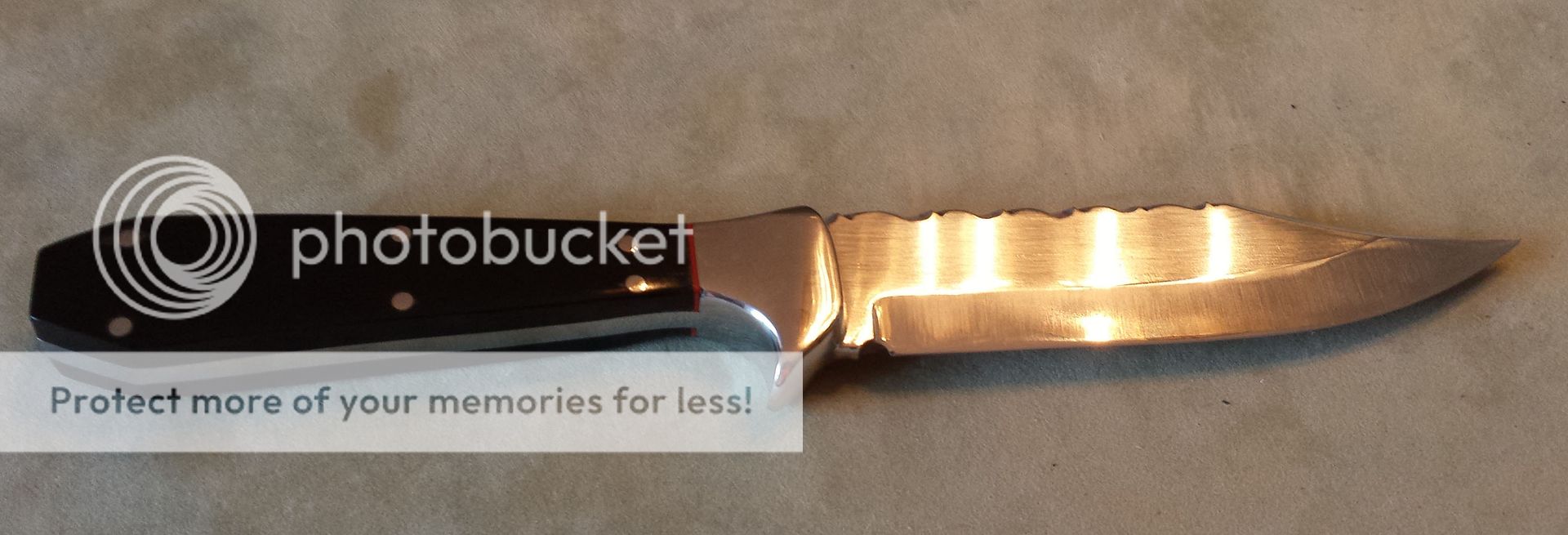

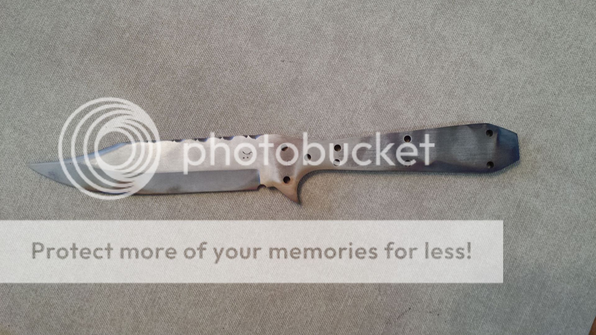

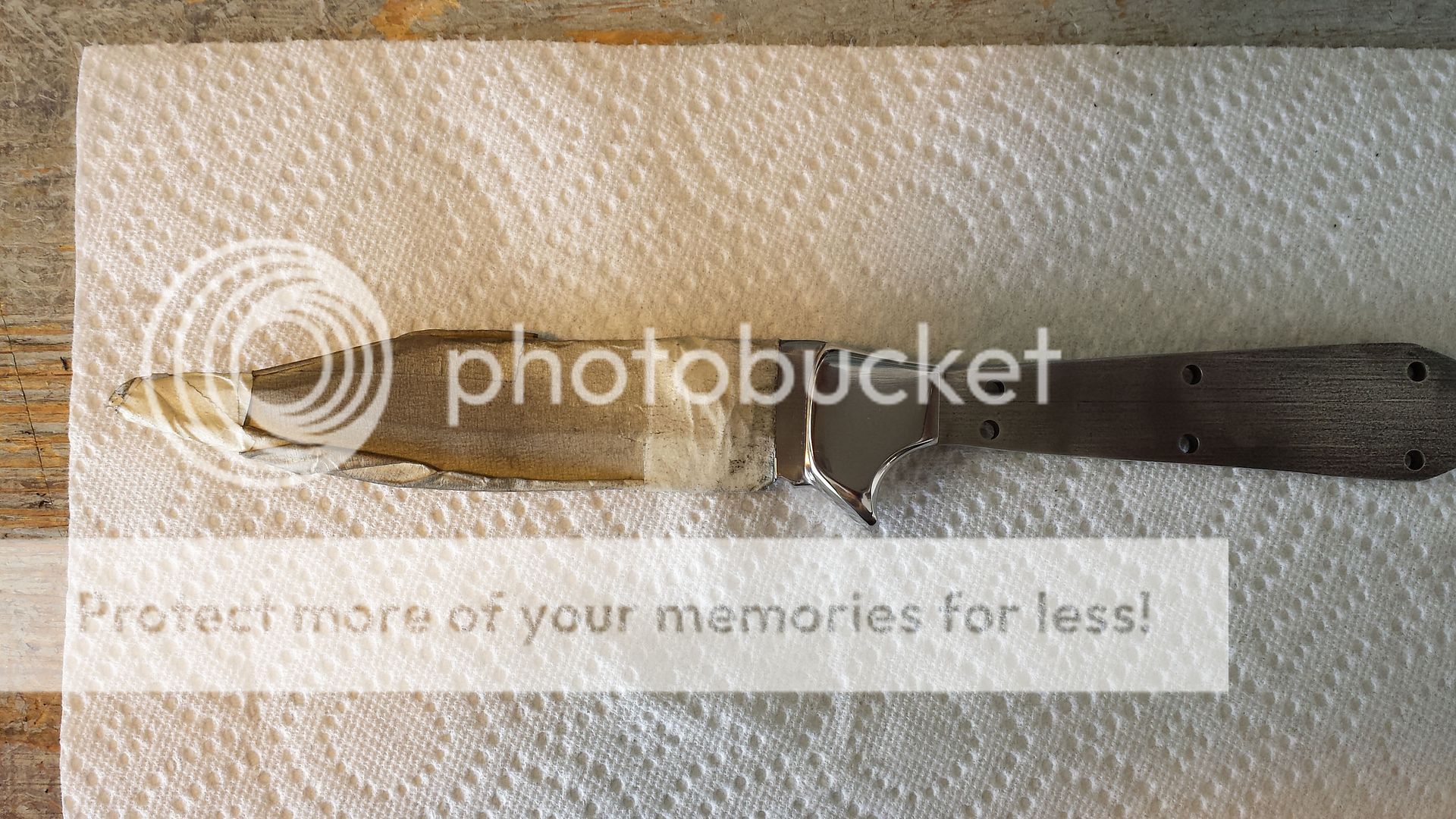

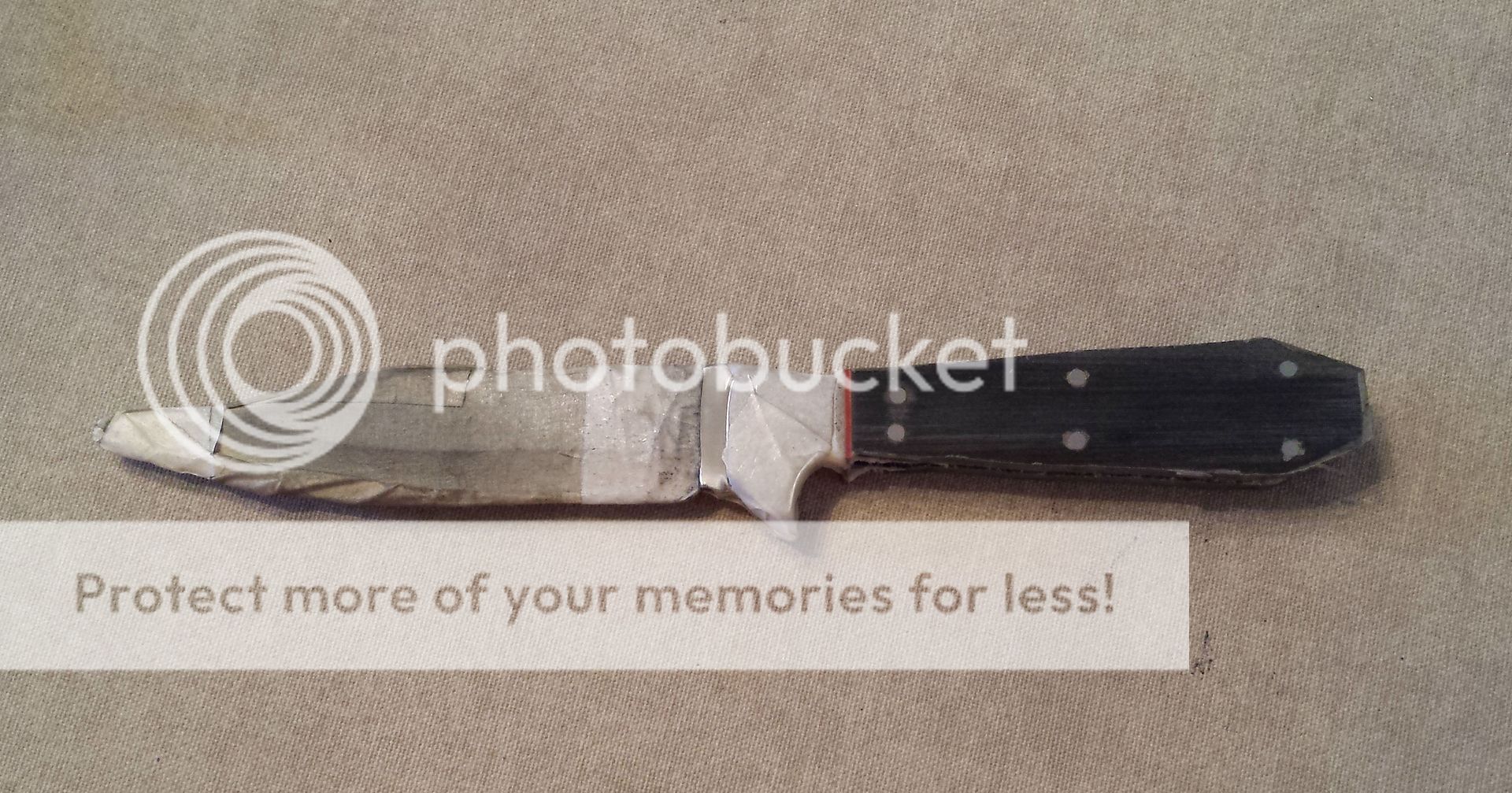

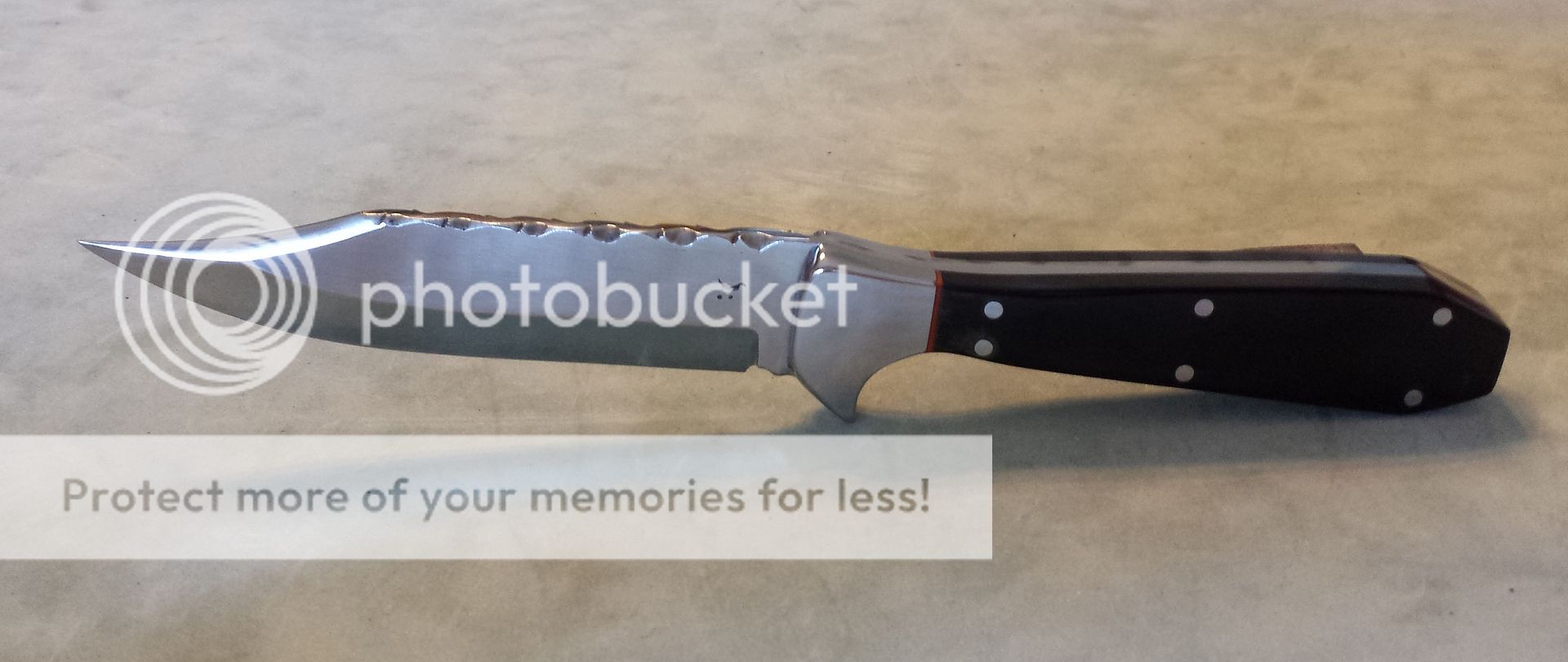

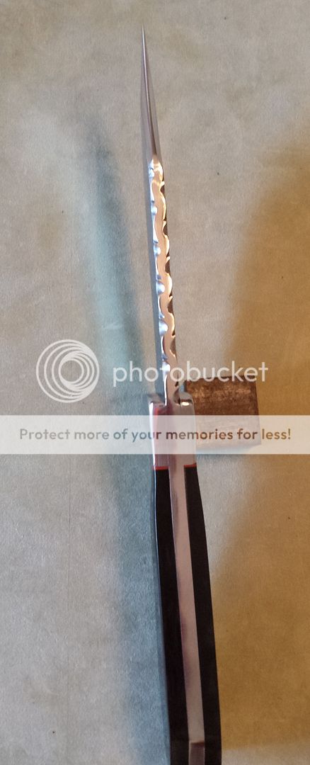

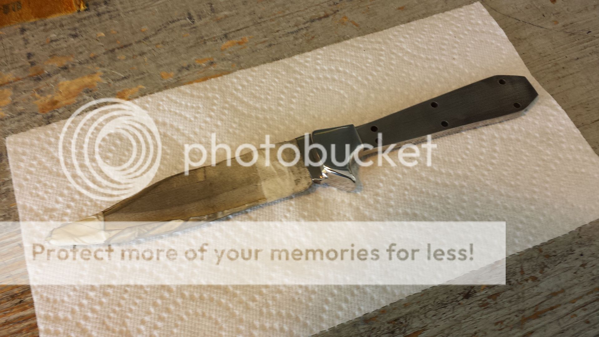

The new Bowie is done. 10.25 inches overall, Blade is 5 inches from tip to bolster. Blade and thorns file pattern on spine. Blade is made from ATS-34 hi-carbon stainless, bolsters from 416 as are the 8 1/8 inch pins that hold it all together. That makes it all "stainless" Scales are black Micarta and red fiber spacers to a high luster, Mirror finish on the blade, very high satin on the rest of the knife. Hardened and double tempered to a Rockwell 60. Balance point is just in front of the finger guard, feels great in the hand. This is a very
nice one of a kind handmade knife. Thanks for looking comments always welcome.
