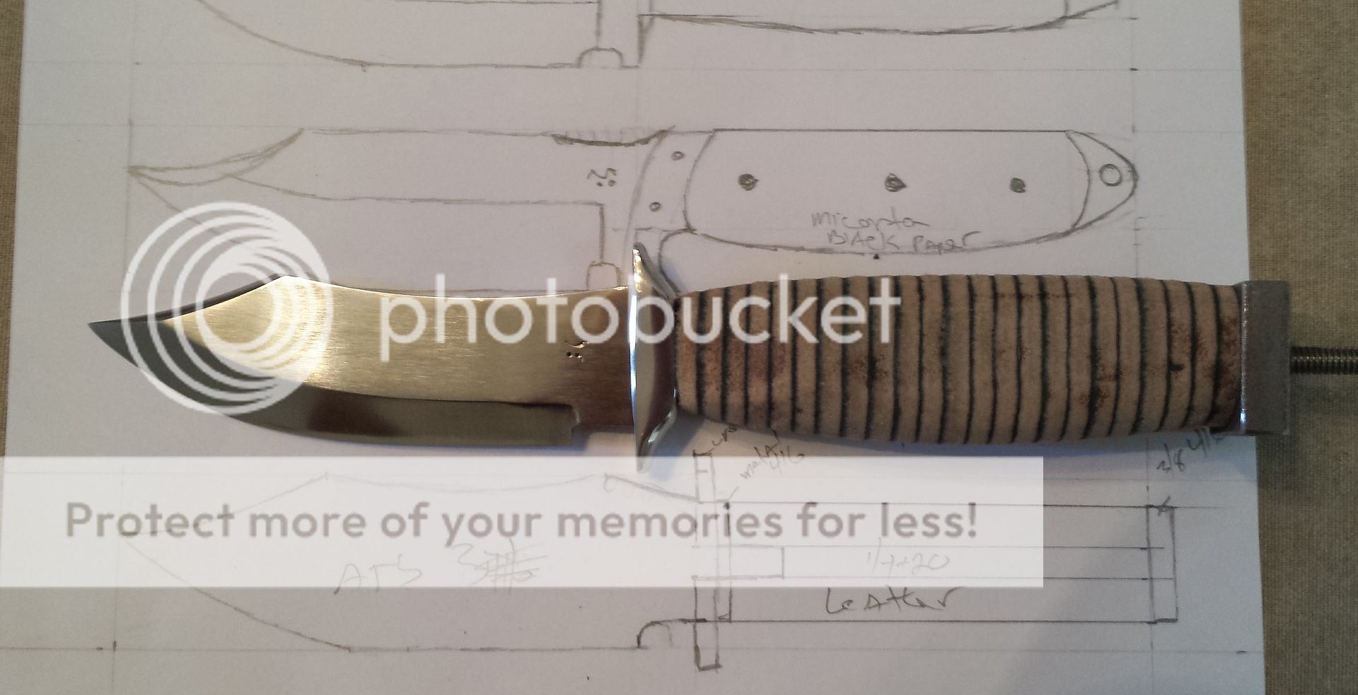

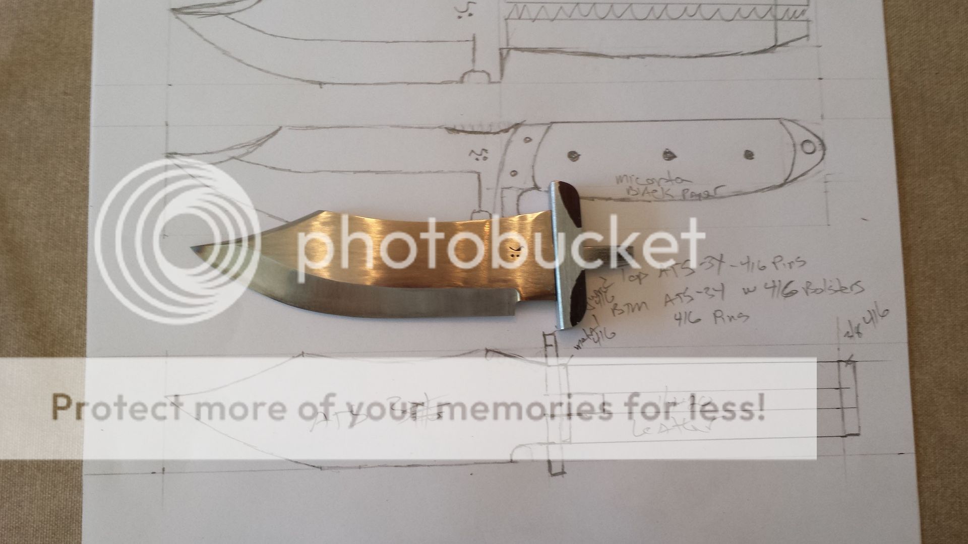

5 inch blade made from 3/16ths ATS-34 , guard from 416 as will be the but cap. Stainless All Thread to hold it all together.

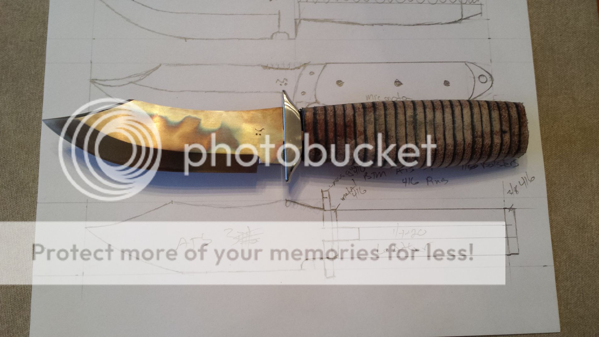

Blade is ready for HT shootong for Rockwell 59-60

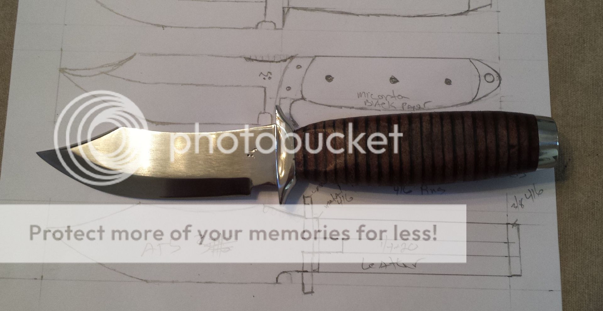

HT and Temper is finished just need the final polish. Guard is finished, stacked leather handle is 85% finished. Just need to make the butt cap (416) and install the stainless All Screw to tie it all together. Should be finished on Sunday.
More photos later.
Thanks for looking Ken
