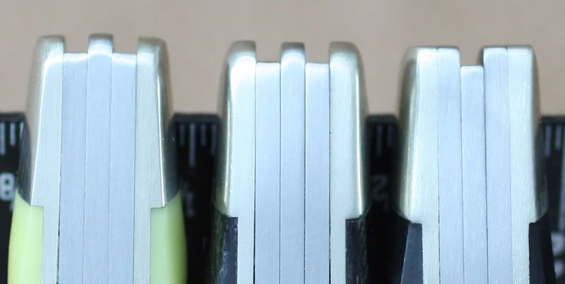

The bolsters and liners are all one piece. They are a metal Buck describes as nickle silver, a mixture of copper, nickle and zinc, in its standard Stockman offerings. But, I have no text proof of its exact makeup. Some special run versions, such as the faux Buffalo scale 301 are described in the catalogs as ALL stainless bolsters and liners, I believe some other limited edition 301s are also SS liners and bolsters.
Black sawcut, Dymondwood and new yellow valox scales are constructed of liners and bolsters that appear to me as all nickle sliver and catalogs state that those bolsters are. Since they are one piece construction they have to be. Or not, website says black sawcut scaless are SS, and Dymondwood scales are nickelsilver. I will have to figure this out a make a list.

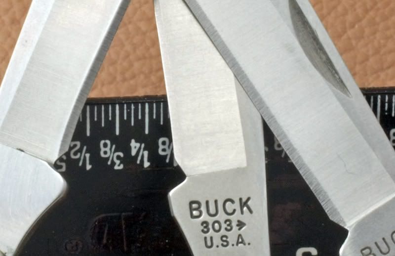

See close-up of the liners and bolsters of the three stated scales but in 303 new models. Liners and bolster have a slight golden hue. SS or NS ?
The amount of zinc used in the mixture would effect hardness of the metal and reduce some scratching.
