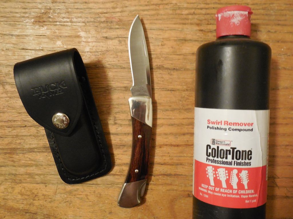

Just got this, and after snapping shut, the blade will sometimes bounce back open a little, and stick there. Or, I can pull it open a little, and it will stick. I cleaned and oiled it, and it seemed to help 95%, but it still doesn't seem to stay closed as tightly as most of my other similar Bucks. Should I oil it better and expect it to "break in", or could this be a flaw? I am able to send it back for exchange, but may have to pay the postage. Any info appreciated.

Thanks guys. Must be some compound in there from the factory sharpening. The compressed air is a good idea. I'll take it over to my garage and set the compressor on a medium pressure and use the squeeze nozzle. I have some good penetrants there too ... Kroil, WD-40, PB Blaster. I'll work it over, now that I know there's no reason to return it.

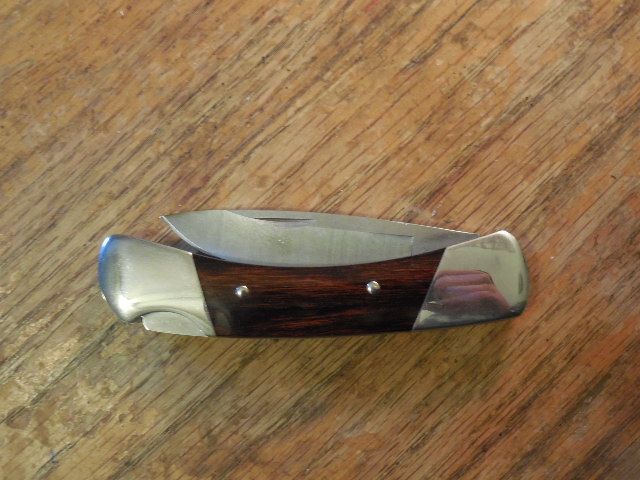

Thanks guys. Doc, good idea about the abrasive compound. I already had some liquid polishing compound that I use for buffing out satin finished guitars. I put some of that in the mechanism a few times and worked it for 20 minutes or so, then flushed it out with WD-40, and PB Blaster, with the red spray tube attachment, and used my squeeze nozzle on the air compressor to keep blowing out the sludge. After it was clean, I lubed it with a couple of drops of Hoppes 9 gun oil. Seems to work as smooth as silk now, and stays closed all the way. I actually have other knives that would probably benefit greatly from this same process. Definitely will put the 500 to use. Here it is with the older one. The shape of the blade is slightly different on the older one.

Good. Glad it worked. I like the way Buck raised the tip up on their newer version of this model. I've used mine for skinning and it now works better for that. DM
