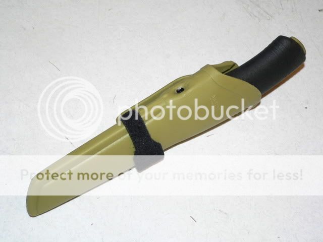

Notice the black spot on the sheath. It is where I have pushed the plastic in. I also cut down that original groove in the sheath a bit.
The Velcro strap is there to hold the belt loop down.

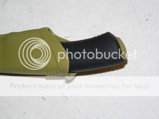

Here I made the thumb ramp for easy knife extraction.

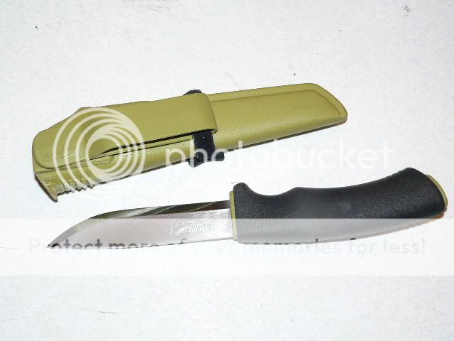

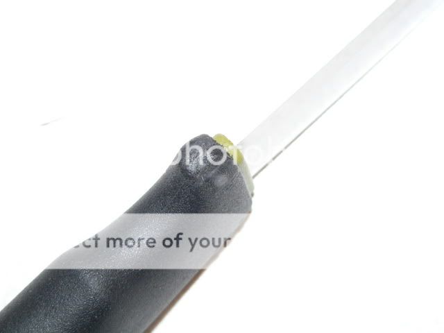

Here is how I melted in some hard plastic (shiny part) into the tip of the handle, so the knife locks very securely into the sheath and there is no rubber drag then taking it out and no rubber handle wear anymore.

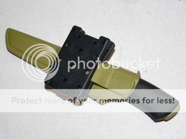

I use tek-loc when I want to carry knife horizontally or attach it upside down to the backpack strap. I still carry this knife the usual vertical way most of the time.
