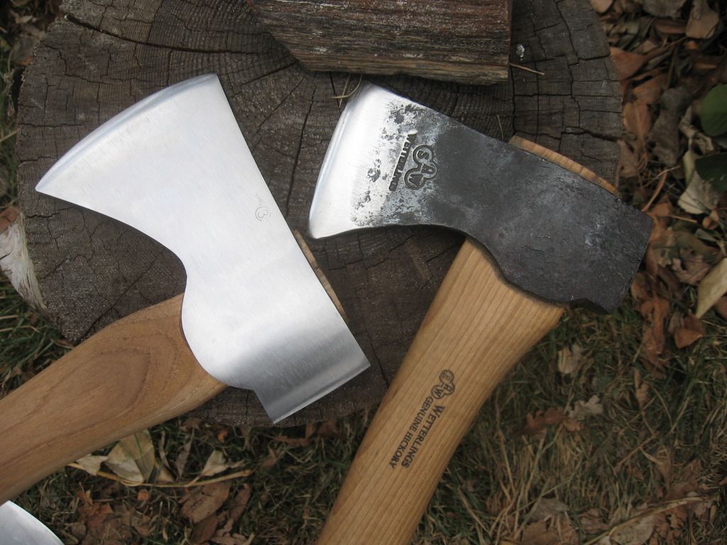

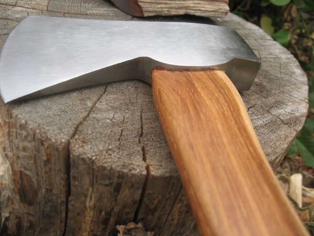

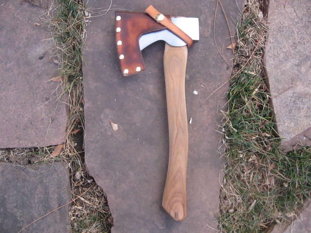

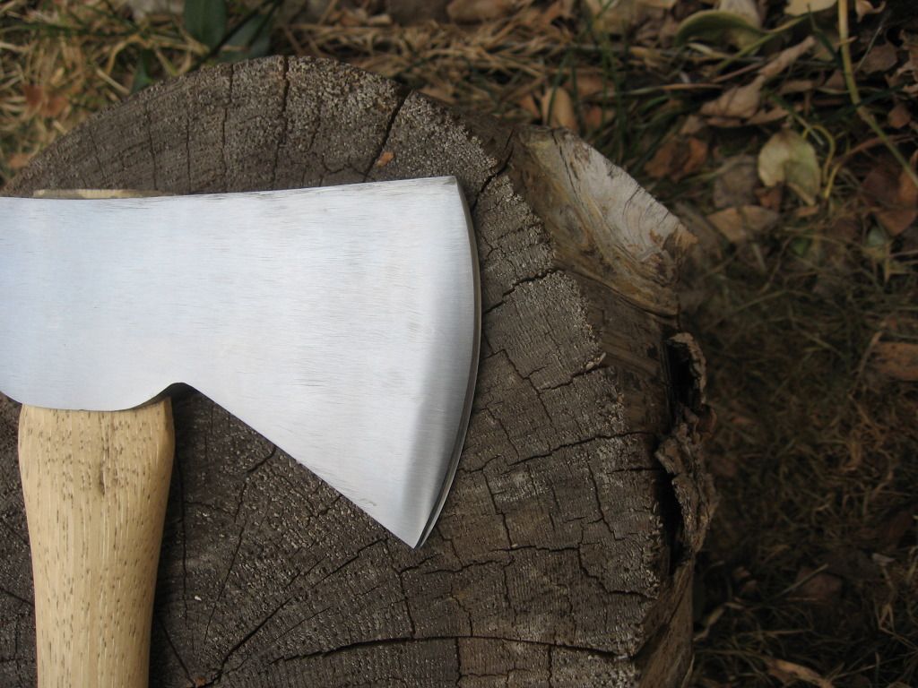

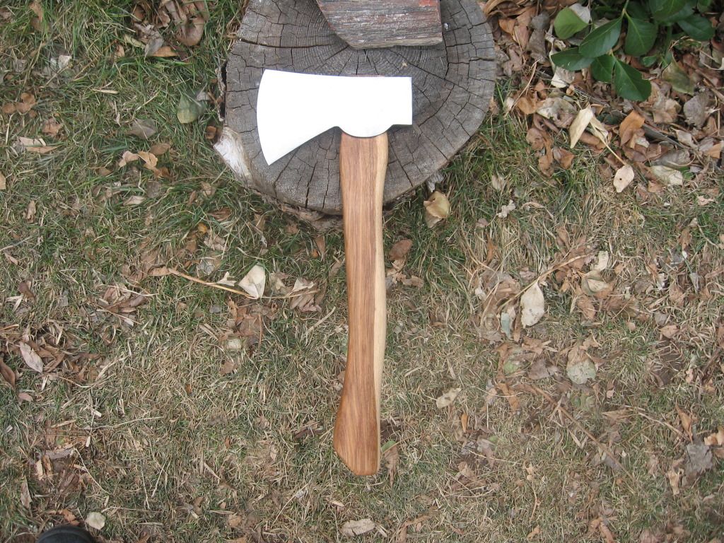

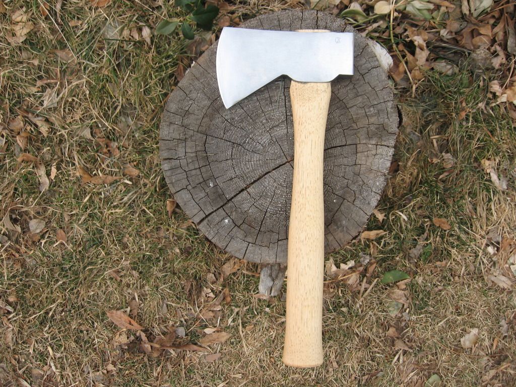

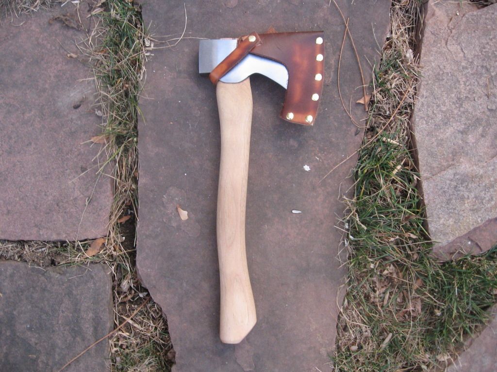

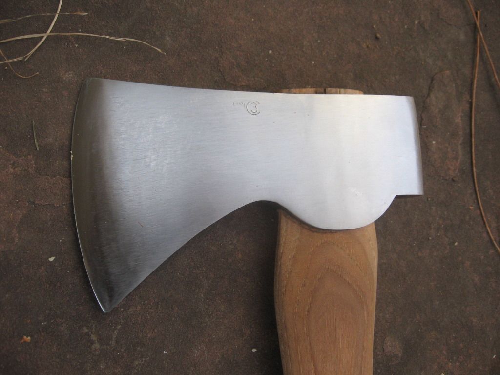

Hey folks, wanted to toss up few pics of my new Bushcrafting Pack hatchet. It's being made from 1060 spring steel and the RC is 55-59, it has a 3.5" cutting face, 5.5" total length, 7/8" width at eye, 12" handle, 25-28oz OAW, Convex edge, 100% made in the USA Bushcrafting Pack Hatchet. Can't let the Sweeds have all the fun.

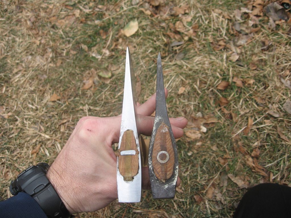

Next to Wetterling Mini
Far superior Geometry to the mini
She Rocks.
Thanks for lookin.

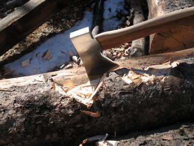

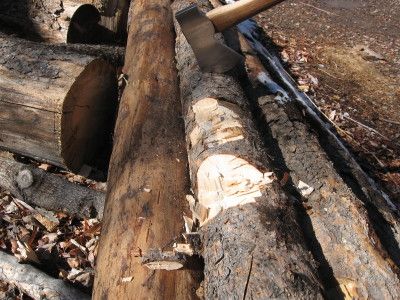

Here is a little chopping vid.
[video=youtube;TZYfBexqDOk]http://www.youtube.com/watch?v=TZYfBexqDOk[/video]
I'll be making a stew this weekend...

Thanks you for the compliment. I am C3 Knives. So far she is exceeding expectations. These are going to be made in very small supply. Took me about a year to get the project worked out, but I think it has been worth the effort. It's a collaberative effort with a local smith. I am cleaning the bits, adjusting the geometry, polishing, hanging and making the head cover. He is doing the rough work and HT on the heads. The pics actually are of the first two, if you look carefully. I got 4 to sell in the first box and they are gone.

Oh boy, Not going to say what I really think of your side by side. You don't need to market this way in my opinion.
That being said you have the makings of a very well ballanced hatchet there. I think it will perform well.
To me, the Eye looks like it needs to be longer, to really benefit from the size of the wings.
Other than that, this looks like a great little axe. The long poll looks like it would help keep the balance right, and it looks well done all around.
I agree with Squarepeg here, I bet a slightly upsized one, on a 24 inch handle would really fly.
Nice work man!

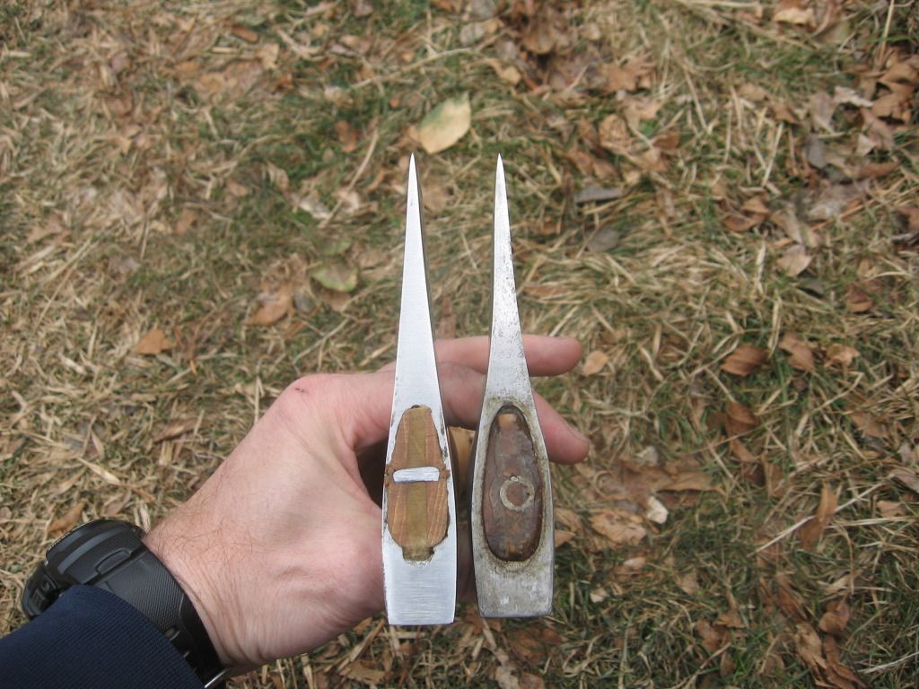

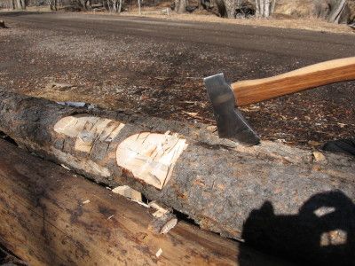

Here are a couple of stills of the test. The result would be the same if repeated. The geometry of the Mini is far more obtuse and does not penetrate the same.
the hatchet with the closest geometry is my 1st Gen Husqie.
Nice work man!

Cody, I can be abit rough around the edges but you will get an honest opinion from me(you no what they say about opinions).
I think your side profile is great. I really like it.
I can see that you have a work in progress there, and you are on the right track. No need to use another manufacturer to measure your product against in public. We all know that the hatchet designs comeing out of Sweeden have room for improvement. Get it right and yours will be the one all the others are measured against. Set the standard.

Nice hatchet. I think you will probably sell everyone you make faster than you can make them. As far as a comparison, wouldnt the Wetterlings SAW13 be a more fair comparison? Same handle length and similar head weight. All things being equal, a shorter handle is going to lose everytime. Just my opinion

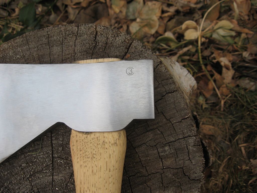

Next box is in and we tried to listen to some of the input. Here is a pic of the newer one. I am going to offer a straight pole as an option for those who would like it. That's not the difference. This one is the same weight as a second gen Husqie hatchet I have in my hands.(It comes in at 26oz OAL.) It was made by wetterling and is unmodified from the factory.
New intro of straight pole option and vid showing whittling, drilling and notching...
