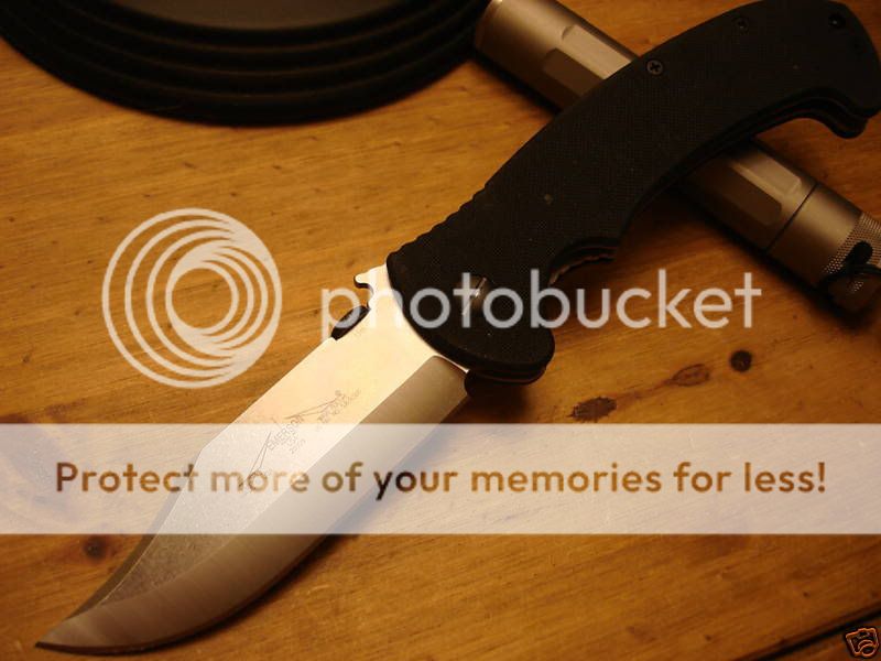

God is good. My CQC13 arrived today and it is beyond wonderful. The idea of a huge clip point folding Bowie done with such finesse and detail for such a modest price really wows me.:D
This knife is easily the sharpest knife I have ever owned out of the box. Crawford customs,Doucette,Dozier,Derr,Nichols, and other hand mades. Spyderco stock and sprint run customs,Bucks,Busses,Scrap Yards,Swamp Rats and ANY other knife I have ever bought new.
This knife from Emerson is literally razor sharp. It shaves hair without any drag. Curls my cigar rings into as many as 81 curly cues...yes that is a true test. Cigar rings can be very thin and flimsy.:p
Very impressed with this folding Bowie knife. Handle curves around the pinky for a firm grip. The whole hand rides well inside the checkered G-10 with total comfort.:thumbup:
And the tip of this Bowie is a real gnat splitter! It is truly needle tip sharp.
But as I have come to know as fact my Chefs Choice Edge Select 120 will devour this 145CM like candy in a 8 year olds mouth.
I need to get a sharpening system that a fool can use to make edges like the one that came with this new knife. So who makes the best idiot proof sharpening system?:confused:
Keep in mind I have NEVER held a sharpening stone let alone tried to ruin one of my precious blades on it. I need the true can't fail way to maintain this razors edge. Anything less than hair popping drives me back to the blade shredding Edge Select 120's spinning stone grinders!:eek:
Help!
