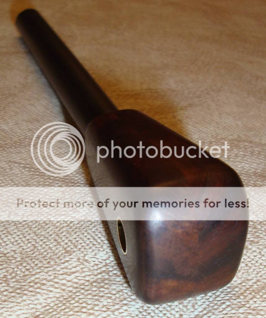

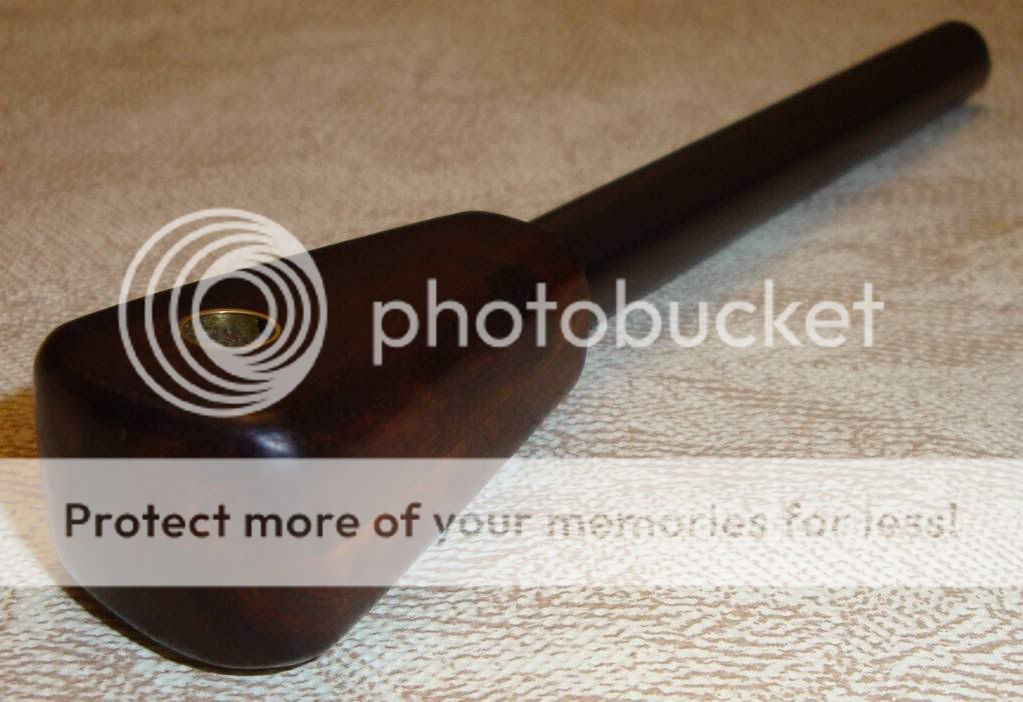

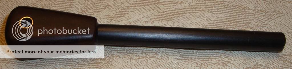

I just finished my first custom wood firesteel handle. I am very happy with the results.
I used some fancy black walnut. It is finished with boiled linseed oil (sanded to 600 grit).
The firesteel is a 3/8"x4" Badger from Goinggear.
My problem know is that I like it so much (and spent so much time on it), I don't want to use the firesteel up!

I looked at this pictures again and it looks like two pieces of wood glued together... RIGHT???
I was thinking of drilling a hole half way and stick the firesteel into it with glue (super glue) ... would this work... is there any reason why this custom one wasn't done like this?
Thanks..
Thanks..
Yes, I glued two thin pieces together (Elmers wood glue) first, to get a thick enough block to work with. I didn't have any thick pieces of walnut that had as good of grain as this thinner one.
I drilled the hole for the firesteel after the block had set for 24hrs to let the wood glue harden.
If I had a thick enough piece to start with, I could have just drilled a hole for the firesteel.

Based on input from one of my knifemaker friends, I roughed up the metal with course sandpaper and used super glue.
So far it is working great.
Good advice. All I can add is that is doesn't hurt to cut a few shallow grooves in the "tang" of the firesteel, to give the adhesive even more surface area to grip onto. I prefer to use epoxy, but super-glue is probably just fine for this application.
Set-screws could work if you file flat spots on the firesteel for them to snug-up against. But there's a risk of the wood itself getting stripped under stress, in which case the screws will get lose and really irk you when you least expect it. I suspect it would be more work, and result in a weaker joint.
You might be surprised how long it takes to wear out a firesteel like that. Unless you use it A LOT, or throw it on a concrete floor and break off a big chunk, it will likely outlast you!
