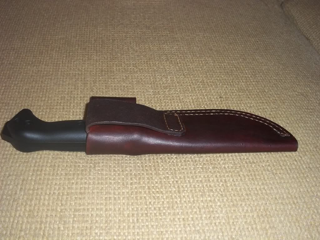

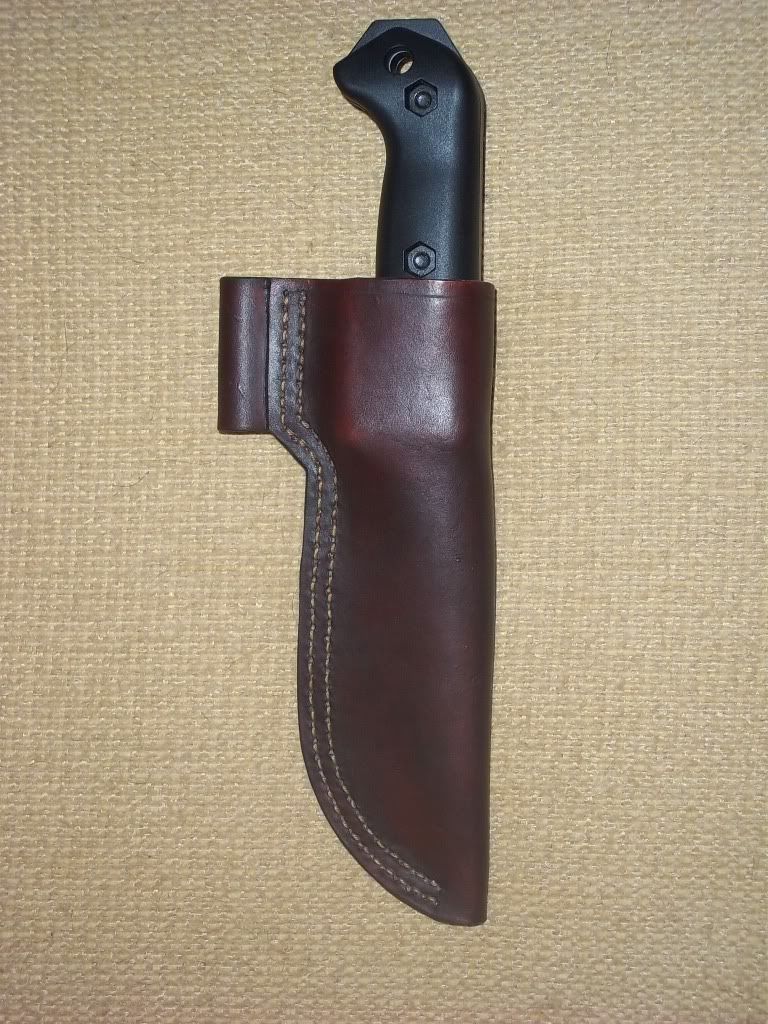

I have 5 orders for BK9's I picked up yesterday and today. Yes, I can, please don't ask about pricing or such on the discussion forums, I have PM and email for that, if you wish to find out. Thanks for the kind words guys.
My sheaths are not pretty, or frilly, they are austere, functional, and tough. Just like the knives they hold.
Its a 10oz shoulder cut, with double nylon stiching, onepiece welt/firesteel loop set for 3/8", dyed with a dark british tan, and sealed inside and out with bee's wax and lanolin. Usually, when I'm done, they feel like kydex.

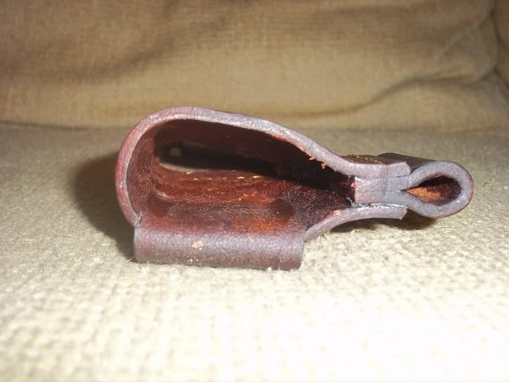

Do you use a one layer welt along the blade portion of the sheath?
I see that the firesteel loop also doubles as a spacer to allow the handles to fit.....nice design.
Do you hand-stitch the sheaths or is it machine-stitched? It looks super-durable and the color is awesome.
Single layer 10oz welt at the bottom with a drain hole that is made into the build. All handmade, no machine ever touch my sheaths, from cutout to final polish, my 2 hooves. Nylon stitching too, and waterproofed inside and out.
