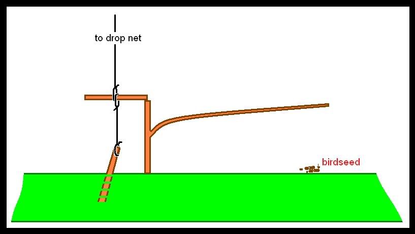

If you leave the side branch long on the trigger stick, it would also work well for birds with a drop net. The bird perches on the side branch and trips it.
Doc
Good Idea Doc, I like it.
I am heading out in a little while I will give this a try.
Bryan
Nice trap !! Thanks for posting. I've never seen this one before. The cord anchor helps to keep it simple. And a nice variation for birds Doc.
