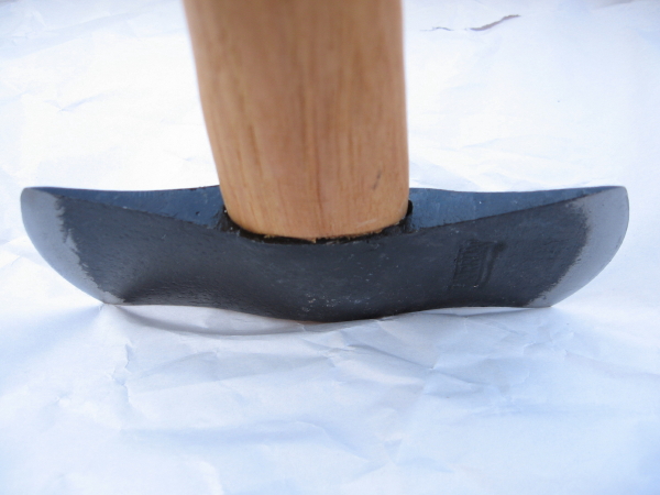

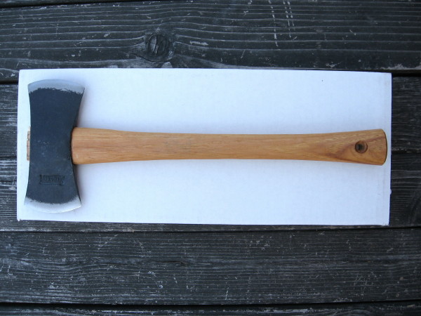

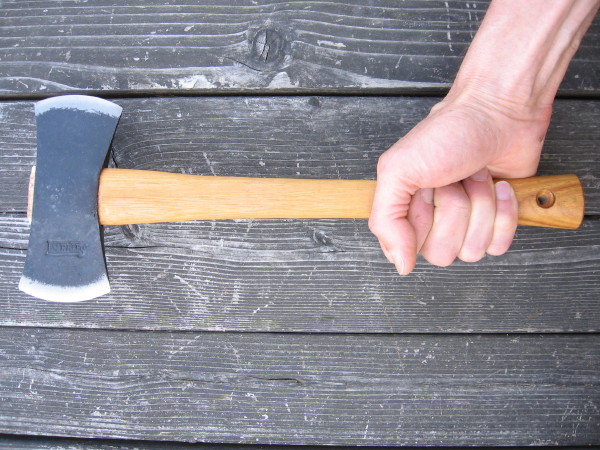

Here's a first look.
Head Dimensions:
Head: 5.5" x 2.5" x 0.75"
Eye: 1-9/16" x 9/16"
Handle:
Length: almost 14.5"
At midpoint: 5/8" x 1"
Finish: lightly oiled
Grain alignment: very good
Weight:
The total weight (with handle) is only 15 ounces.
This is significantly lighter than a smallish vintage 14" Swedish hatchet I have (Super Banko) whose total weight is 25 ounces.

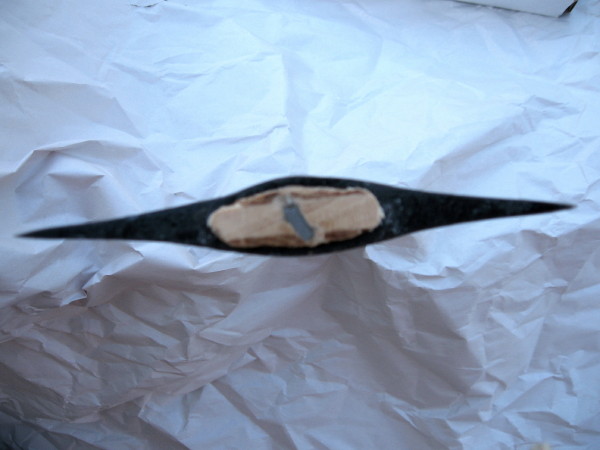

Profile and Edge:
I'm pleased to find that the edge profile and thickness near the bit is comparable to that on the Swedish hatchet mentioned above. The photo below is blurred, unfortunately, and you have to look at the blurry part at the very edge to see the actual profile. The factory edge was fairly sharp. Two inches back from each edge is the beginning of the handle/eye, at which point the head thickness is 7/16" for one of the bits, and 1/2" for the other bit. (Now I know which bit should get a finer edge and which bit to keep thicker.)
There is some deformation visible on the upper left side, but it doesn't seem as bad as the above photo looks at that camera angle. The wedge is relatively wide, taking up about half the eye width. The metal wedge is 5/16" as shown. The head alignment is good but not perfect. The edge grinding job is also good but not perfect, but it's better than on the Cold Steel tomahawks I've seen.
The hafting job seems pretty good, but there is a small gap on one side of the lower eye (as seen in the above photo).
For the money spent, I'm thinking "so far, so good". I'll sharpen it up and try it out. I'm curious to see how it holds an edge, how the weight and length combination will perform, and I want to do some hard chopping to see how secure the head is.

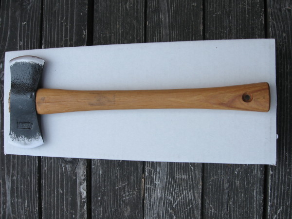

The filing of this hatchet was compared with a couple other axes that were nearby. A Plumb hatchet seemed a little harder than the Marbles, and a vintage Gransfors axe seemed significantly harder. After using a file/puck/strop, both bits on the Marbles could shave hair from my arm. The edge near the Marbles stamp is the finer of the two.

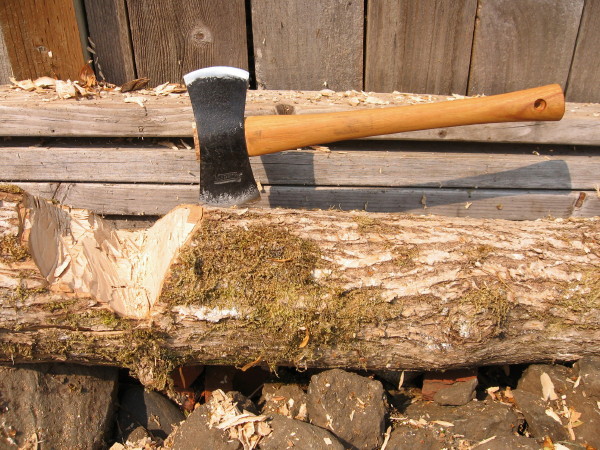

I did some hard chopping on this ash log, using only the thinner bit. For cutting the left side of the notch, I soon switched to my less-accurate left hand to reduce the backswing hazard from the rearward facing bit.
After chipping away for a while, I stopped here, took the photo, and checked the head tightness. It had not budged. I also re-checked the sharpness, and the middle of the bit could still scrape off some hair from my arm, but not as easily as before.
My impressions after this limited trial:
For the money spent, I'm not regretting the purchase. (I've spent more money at that auction site for a worse item, probably more than once, if you know what I mean. ;) ) I would never spend the going price a double-bit Norlund or other vintage saddle axe, and the previous version of the Marbles double bit looked worthless. Now I have a sub-one-pound hatchet (total weight including the 14" haft) to add to my "collection". Maybe it will prove to be handier than my other hatchets for certain uses.

My updated impression of this hatchet is that the workmanship looks good, the steel seems okay, but I realized that I don't like using a double-bit hatchet, with that back edge on a short handle coming toward me with every stroke. Also, the weight of this one is particularly light (just under a pound including the handle), it seems like it just "pecks" at the wood, and I would prefer using a heavier single-bit hatchet.
