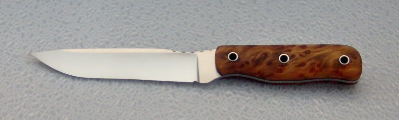

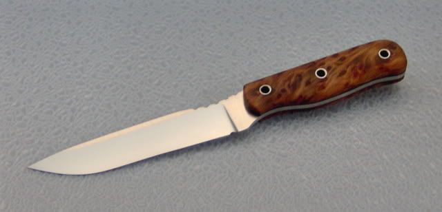

This is the first of one of my new designs (and my new personal carry knife!) I built this knife for slicing and piercing ability, and it grows on me the more I handle it. This edge cuts like a straight razor! I'll be making more soon, in my usual A2 and in CPM S30V. Here's the specs:
4.75" recurved cutting edge, 9" overall, 1" wide
5/32" thick A2 tool steel; H.T. and cryo quench by Paul Bos @57-59rc
Deep hollow ground blade, 400 grit satin finish
Stabilized redwood burl lace handle scales and black spacers
Thanks for looking!
