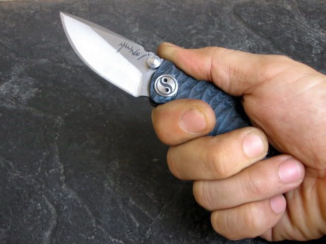

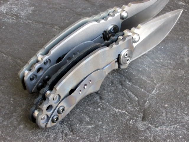

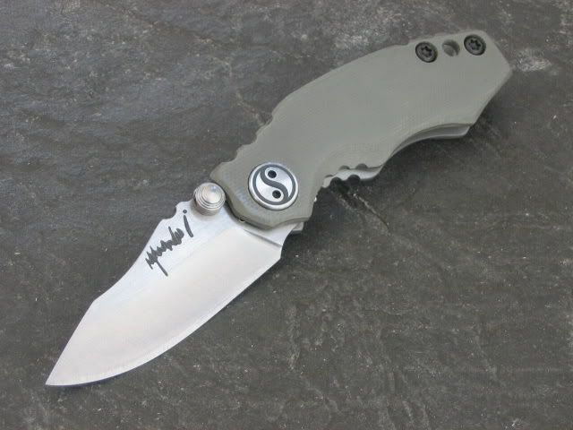

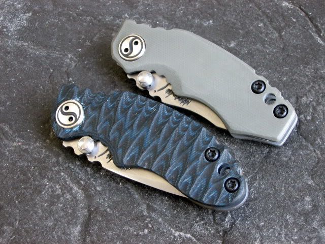

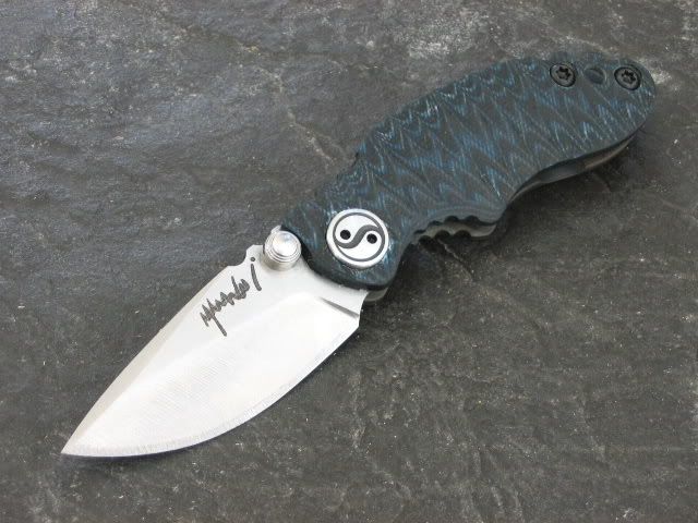

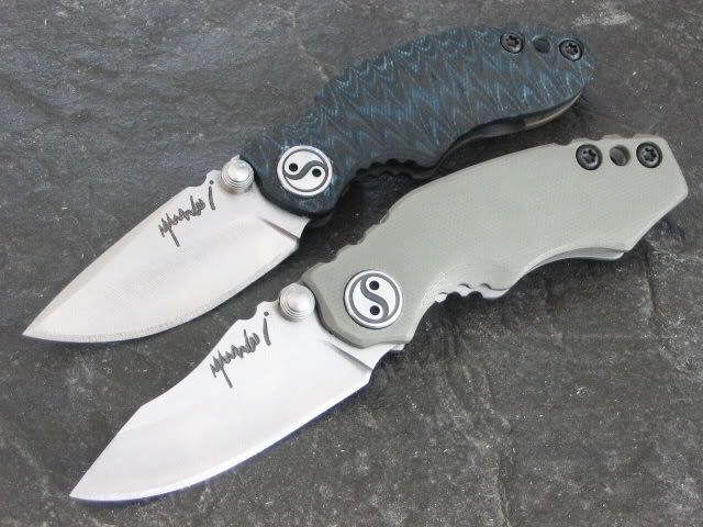

Hi all,
Just finished for the first new designs of 2009.
EQ, design for EDC. This is smallest frame lock folder that I ever made!
EQ-1 and EQ-2
Spec is:
Blade steel : ATS-34
Thickness :1/8".
Blade length : 2 1/4" from tip to handle
Closed length : 3 1/4"
Opened length : 5 1/2"
Blade Width : 1"
Handle : G-10
Locking system : Frame lock
Frame : 6AL 4V titanium 1/8" thickness.
Clip : 6AL 4V titanium
Pivot : Hardened 440C in Yin-Yang style.
Thanks for looking.
