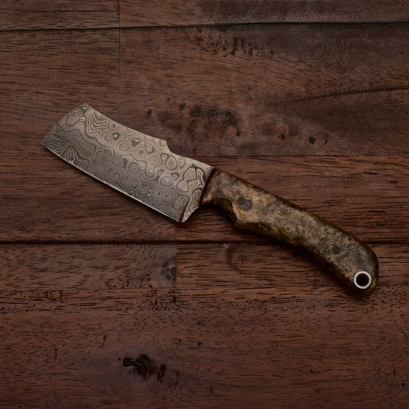

I like the mini cleaver, though i might make the handle a bit straighter. i also like the one on the left in your original photo, but if it's intended to be a hunting knife i don't know anything about them.
All of them look good as learning projects. Design and ergonomics is hard to learn, so they look like a good start.
I can't understand why people love mini cleavers.
What kind of handle material will you be using?
In all honesty I'm not sure how much I like them either. I just wanted to try drawing one out. As far as handle material, I'm definitely using wood. I'm just not sure what kind yet.

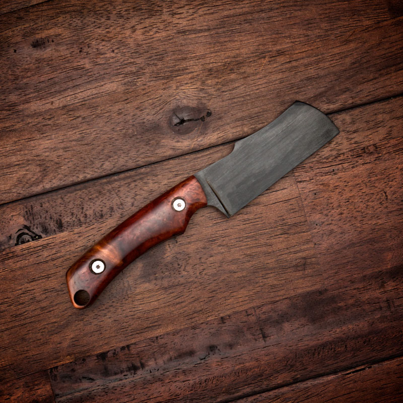

I did a few what I call Mini/Pocket Cleavers. They worked out to be great working utility knives. They wanted something that was more of a fancy box cutter to carry around at their restaurant that he didn't worry about having in his hands in the tight confines of a restaurant.
What kinds of woods do you have for handles there?
The Damascus is Silverback buckeye burl and the other is Red Mallee burl. Buckeye is a great wood to work with as long as its stabilized. its like balsa wood if its not.. one slip on the grinder and half your handle is gone.
