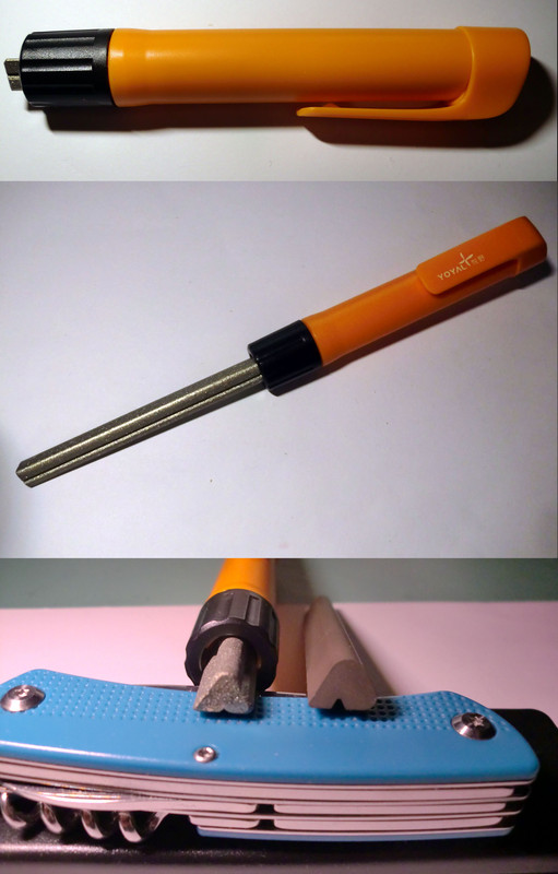

Due to prolonged problems with wrist and shoulder I have not been able to do much sharpening during last months. Today I took two diamond sharpeners out of the drawer.
Both are new. One is Chinese - Made in China, coarse grit (360 JIS). I contacted the manufacturer, they confirmed grit and standard.
The second one is US - Made in China, fine (600) grit. I don‘t know what grit standard Lansky uses for their diamond plates / hones. Be it ANSI or JIS, it should be finer than coarse 360 grit.
To my surprise they feel the other way round. The coarse one feels much finer than the one that should be a fine diamond plate. As mentioned before both need to be broken in. As both are Made in China (and the Chinese Made in China is manufactured by a big name on the market that does OBM and ODM business) I can‘t imagine that quality will be much different. Especially as both sharpeners look identical in design, shape (only the bodys color is different).
I don‘t have a microscope to make a particle size comparison. I appreciate any advice.

Link to photo / webhoster removed. See my third posting (posting #8 in total) for a new photo.
I don't know how to call them. Lansky calls it a retractable diamond pen. The Chinese one is called a "Multi-functional Knife Sharpener".
Both have different radii, like the Lansky Spyder Sharpener.
The photo seems to be the best as I can. That's my phone's camera max. zoom.

As I mentioned before I like those ceramic bone / crock stick sharpeners from Lansky. I use the Spyder Sharpener quite often to sharpen Swiss Army Knives or knives with a shorter blade in general. The profile of this ceramic hone is versatile, works for spoon knives or bread knives (with serrations), too. As both diamond stick sharpeners were on sale - I think I paid ~ 20€ for both - I thought I give them a try. I agree, they are narrow and might not be easy to use. The ceramic Spyder rod works better, although it is as narrow as the diamond ones. But I can hold in between thumb and pointer. The plastic casing is a little bit annoying. I would prefer if it would be possible to take the diamond rod out of the casing.
The lower one (that is the "finer" that feels coarse) is from Lansky. The upper one is the much cheaper Chinese made. As the Lansky rod usually is ~30€ I have doubts if it would be worth the money.
I think I will take an old, cheap paring knife that has seen a lot of abuse by carbide pull-through sharpeners for breaking in the diamond rods. I am curious how that works.

Yes, they are. The rod is retractable (well, the tip of the rod sticks out of the casing).
[url=https://postimg.cc/Q92sT1Q2][/URL]
The third image shows the Chinese Sharpener next to Lanskys Spyder Sharpener. As you see they have more or less the same cross section. That's why I bought the diamond sharpeners. For field use as well as for sharpening other than plain edges.
Comparing mine with yours they look very coarse. Even Fallknivens fine 600 grit diamond plate - which comes quite coarse when new - does not feel as rough / aggressive / coarse as the one made by Lansky.
