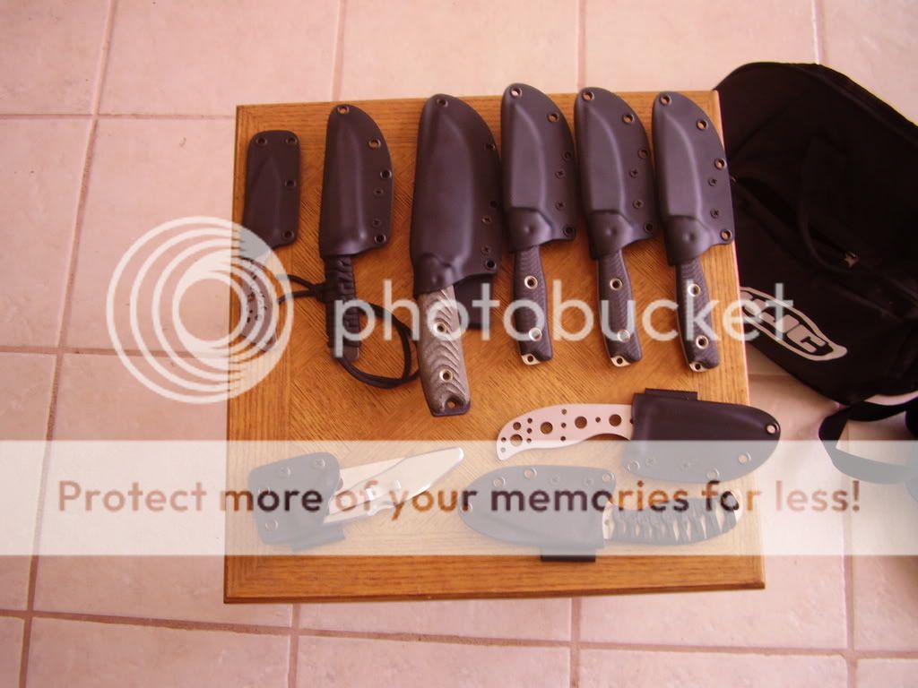

Here are some great HCLE sheaths that showed up with a few pals from Eric at OST today.
