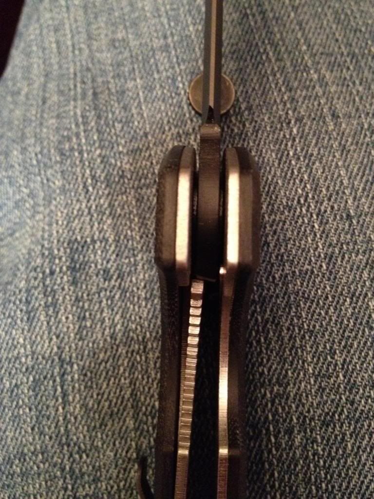

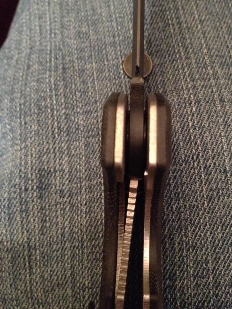

First (my main issue): when I fold out the knife in a regular manner using my hands, the blade seems to have a nice "early" lockup.
BUT when I use the "wave" feature to deploy the blade, or when I use my thumb to flip open the blade with a jerk of my wrist, the lock seems to slide very far down on the bottom of the tang (late lockup?) and its almost impossible to unlock the blade using my fingers. I keep a quarter in my back pocket to unlock it now.
-Is this normal, and will I eventually be able to unlock my knife with only my thumb, or is something wrong?
Thank You very much for the replies in advance!
Also Ill post up some pictures as soon as I learn how to upload pictures! :) ****FIXED****
EARLY lockup, from regular opening without any wrist flick
LATE lockup - this is what I am unable to open unless I use a coin, or something else to assist the lock to open

Tighten the pivot to eliminate the bladeplay. If there is some side-to-side play, that might be what's causing the lock to engage further when opened with some force. If the blade becomes hard to open when the pivot is tight enough, try taking it apart to clean the pivot and washers, and assemble it dry.
There's also a huge difference in velocity (and thus force) between opening with your thumb and waving. Most of mine always engage a little more when waved. Also - not sure if this is the case, but if it's loose enough to "flick" open without thumb contact on the disc at all times, it's probably too loose.
Honestly, the waved pic of lock engagement isn't what I would call late at all, as well...
