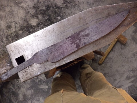

I am doing a new experiment.
My first multibar damascus.

Nice work, Erik. What did you use for the "spacer" material? 15N20?
The steels used are 115w8 and 75ni8 (wich is much like 15n20).
Not shure about the handle yet.
Thanks for the compliments!
Erik, how dark does the 115W8 get when you etch it?
As far as i can see it will etch quite dark but I haven't hardened the blade yet.
I do not think it will be as dark as O2 but it will have enough contrast.
