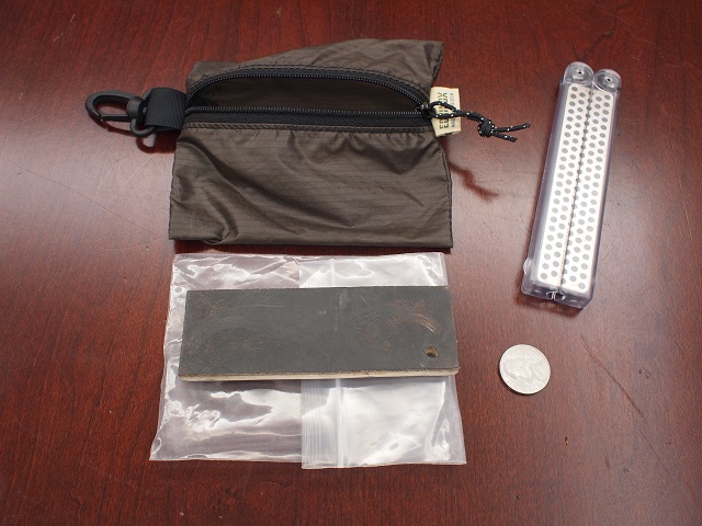

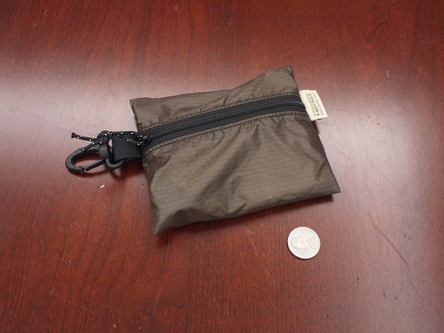

I finally got my new field kit together and figured I'd share here. The kit comprises a DMT XC/C Diafold Sharpener and a DLT Field Hone loaded with Bark River black compound, stuffed in a Equinox Marsupial Pouch. The whole thing weighs 3.5 oz.
(nickel is for scale)

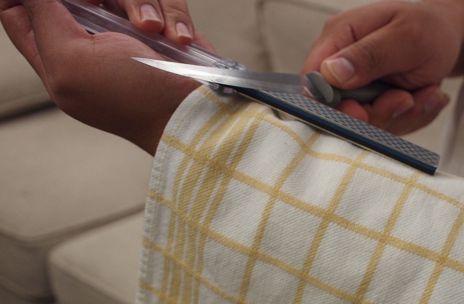

After much trial and error, I settled on the technique you see in the vid. It’s very comfortable and allows for excellent angle control. EDIT: However, you should be extra careful because you're cutting very close to your wrist and slipping off the stone is easy! I do it accidentally in the vid. From now on, I will cover the wrist with something when using this technique!
Cover your wrist, like this:

Are you not concerned about how close the knife is to your wrist while sharpening?
I'm not sure that is how I would school the uninitiated on youtube to sharpen a knife.
That's a good point, and I said it in the vid. It's dangerous if you're not careful. It's good that you noticed that! I'll repeat here: BE CAREFUL IF YOU DO IT THIS WAY BECAUSE YOU COULD SLIP OFF THE STONE!

What you are proposing is a very dangerous sharpening technique.
I "slip off the stone" all the time, and I've sharpened more than a few knives.
This is the reason that the Sharpmaker comes with guides.
I would suggest promoting techniques that will not result in a person being injured if (read "when") they happen to slip, especially n00bs.
As a side note, I'm curious: I've never seen anyone use a technique such as this, did you learn it from someone else where we might have a look, or did you come up with it on your own?

Pete, I tried using it like Scott Gossmann does (vid above) and holding it out like a paddle, etc. I haven't seen anybody else use it the way I do. You just have to be careful, like when using any equipment.

Could ? Why you actually slip off at 5:12 ,,
Very unsafe practice that , never cut against yourself , or in this case rub a blade on a stone in that fashion.

And something people have to understand is that sharpening a knife is inherently dangerous. You are putting your skin very close to a (if you're doing right) very sharp edge that is only getting sharper. And i have to say, the most annoying thing I hear when someone watches me sharpen a knife, even when I have the stone on a table, is that you shouldn't cut toward yourself. You just have to know what you are doing. Otherwise, you are only sharpening half the bevel.
ETA: Speaking of cutting toward yourself, and rubbing the blade. I do both those thing in the third picture very quickly.

I´m pretty sure its just as effective using a steady surface instead of your hand towards your wrist also it will be easier
to maintain an even angle .

That's true, but the point is that it's a field kit. I use this technique because you don't always have a flat surface at the right height.
For safety, I'll make sure to cover the wrist from now on. I'll make a follow-up vid at some point when I use it again, this time being extra careful to address safety. I certainly don't want someone to try this and cut themselves. But I do think you're overplaying the danger. If you cover your wrist and pay more attention than I did :), you'll be fine sharpening this way.
I edited the OP with a safety acknowledgment.

It might seem to be dangerous but the amount of pressure with the technique is limited, the main artery itself is blocked by the sharpener, and lastly, the blade movement is not cuting directly into flesh, more a sideway landing if one slip.
