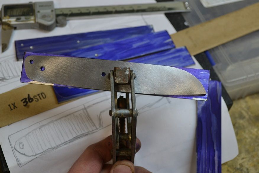

Here's the start, I first worked my design out on paper. I have made a few of these so I had the basic template worked out in my head already. I wanted an exposed pommel and lanyard hole along with a profile that is great for in pocket, concealed or necker carry.
I cut my bar of A2 into 6 rectangular "coupons" with my chop saw and then ground the first one to profile. Once I was happy with the lines I scribed them on along with transferring the holes onto the next coupons. Each one is made to tight profile tolerances as a result of this technique.

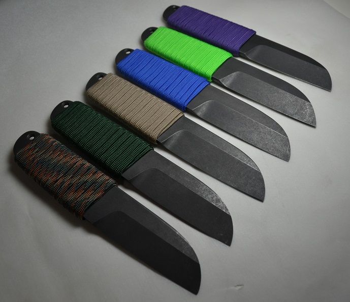

Wraps are ready to soak! They will get a bit darker after soaking in epoxy, the emerald green came out almost black.
I'll have more later, the epoxy is curing right now. Feel free to ask any questions, these are coming along nicely! :D I'll probably satin finish the grind and blend it with the edge for maximum sharpness and cutting ability.
