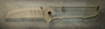

Hi everyone, I wanted to share my new folder design and get some feedback, This will be the first folder that I have ever made so please let me know what you like and what you might change. Thank you for looking! Blade length 3.5'' 1/4'' Pivot, 1/8'' hidden stop pin, 1/4'' I.D. X 1/2'' O.D. P.B. Washers, Stainless blade... thinking 5/32'' thick S35, thinking of making the pivot head oversized on the locking side for an over travel stop I know I have seen this before but - (if anyone knows if this is patented please let me know as I do not want to do things the wrong way) And I still need to come up with a name :)

I cannot open your attachments, but I do understand your excitement having made a plastic knife.
I have made plastic models and carried them for a few days, just as happy as if I had a shiny new custom:)
Really nice looking design! I carry a kershaw folder for daily stuff and a full tang for "defense" is be willing to trade out my folder for yours!
Are the frames going to be contoured or flat? What made you choose the 1/4 pivot size vs. 3/16? Really liking your design...
