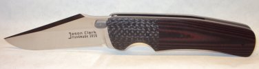

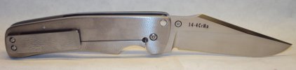

Here is my latest folder. It is a frame lock with a .125 thick Ti locking side with an orange peel finish and a .65 thick non-locking side with a carbon fiber bolster and red and black G10 scale. The back spacer is G10 and thumb opening tab is Ti. The blade is 14-4CrMo stainless steel. Its has an in-house milled Ti pocket clip. Blade length from the bolster is 3.5", closed length is 4.5", and the overall length is 8".
Comment are welcome.
Thanks for looking.
Jason
