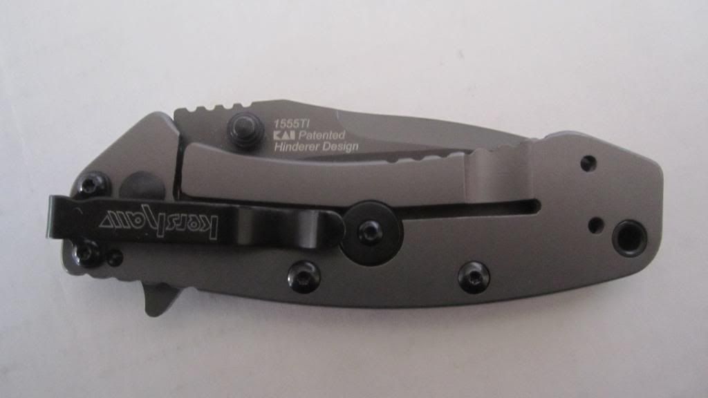

Third in line is the Kershaw Cryo II Blackwash Tanto.
Normally I wouldn't buy a tanto bladed knife, I don't care much for the fact that they don't have any belly on them. I purchased the tanto version of this knife because I plan to use it as mostly a utility knife, where the ability to use the flat tip as a scraping tool or chisel could turn out to be advantageous. I chose the Cryo II over the Cryo I for the fact that it's a bit larger and easier to handle. The knife is pretty comfortable, and the jimping helps give some grip to the otherwise smooth and fairly slippery surface of the metal handle. It does feel decidedly small after handling the ZT knives, and it's obvious you're not going to be able to use it anywhere near as hard before grip becomes a problem. I like the look of the blackwash, it makes the knife less flashy, and should be relatively discrete should I need to use it in public. The knife locks up nice and tight, as you can see in the next two pictures, the framelock works well and has a lot of engagement. That said, it could prove to be something that gives the knife some long term durability issues as the lockbar wears, opening up the possibility of blade play. I think part of why this knife is smooth firing and rigid is the phosphor bronze washers. You can see a hint of them in the second picture. This knife is noticeably faster than the ZT 0300 thanks to the immensely lighter blade, and fires in a satisfying way.
This was the least sharp knife of the 4. It would slice cut paper, mostly. It also has the worst looking edge grinds of the 4 knives. There is visible waviness and a visible difference in the grind angle/depth from the left to right side. I suspect this is a byproduct of the low price point of the knife, and the strange recurve on what will become (after I sharpen it) the lower straight section.
Not the best pictures but you might be able to see what I'm talking about.
Amateur sharpening job aside, I like this knife, and thanks to its modest cost I'm not at all afraid to use and abuse it as needed. In hindsight, it's a tossup on whether I'd get another tanto version again or if I would have chosen the standard blade.
