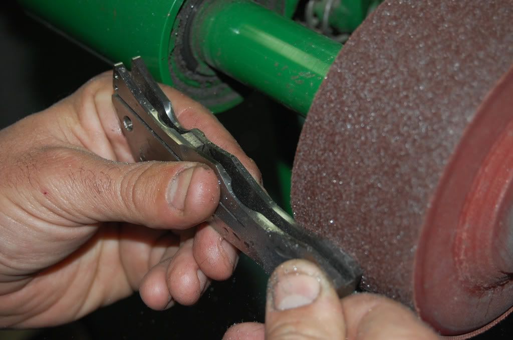

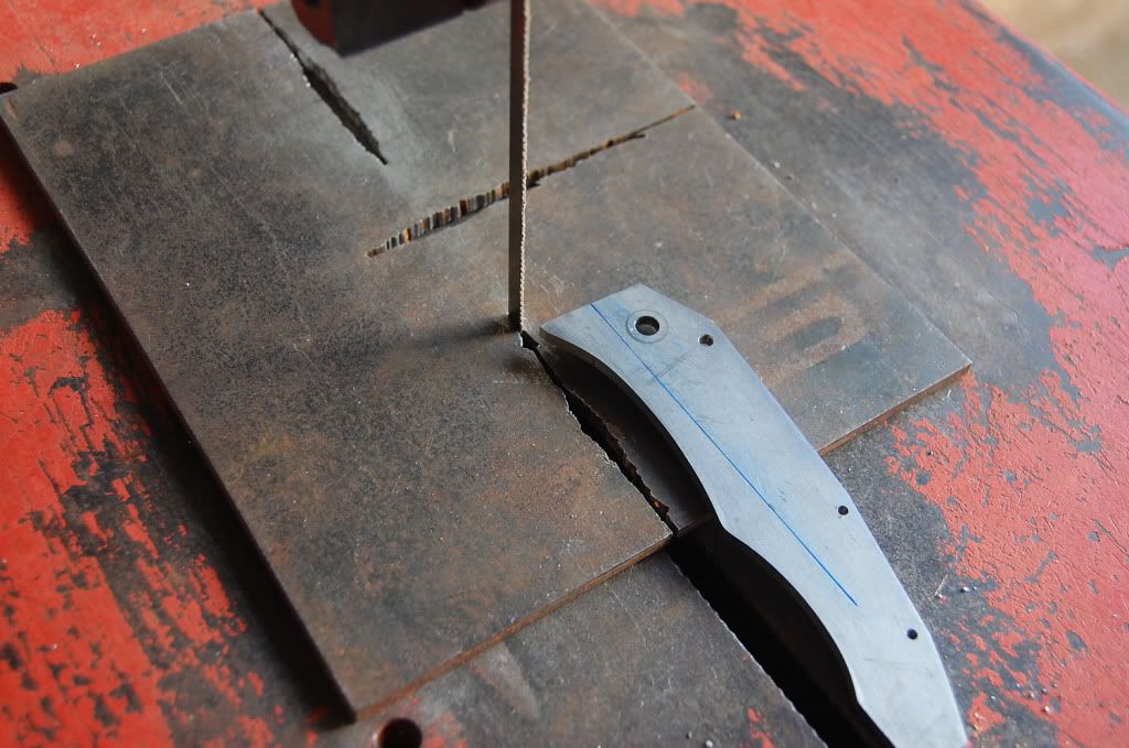

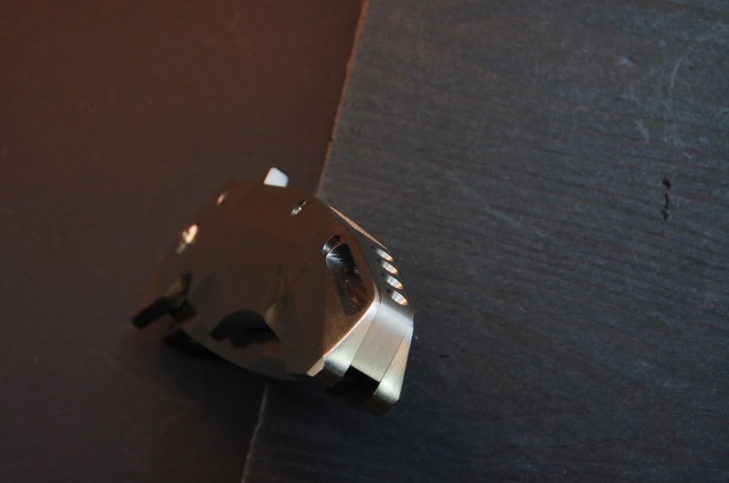

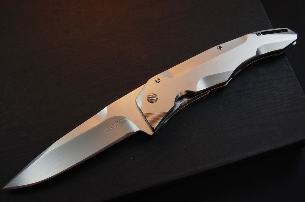

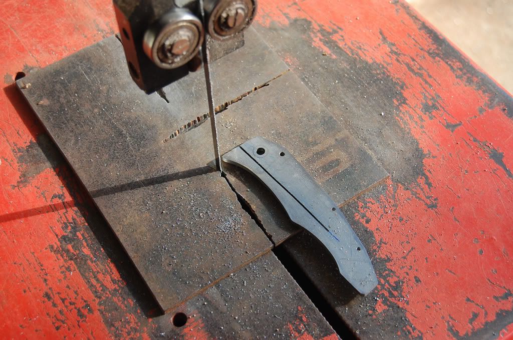

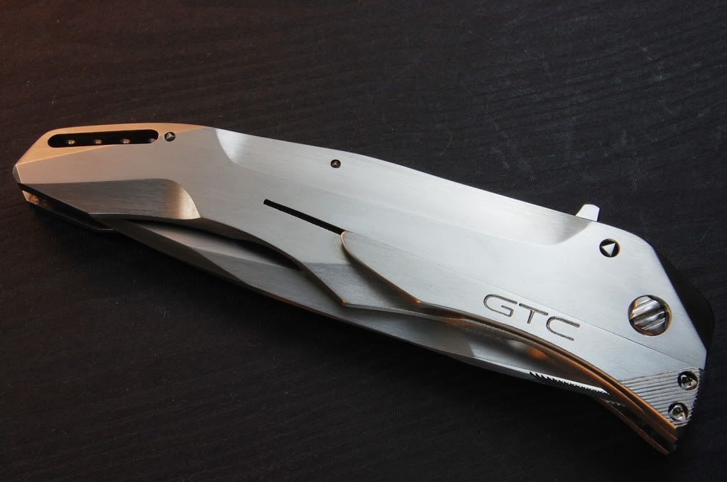

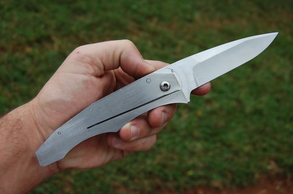

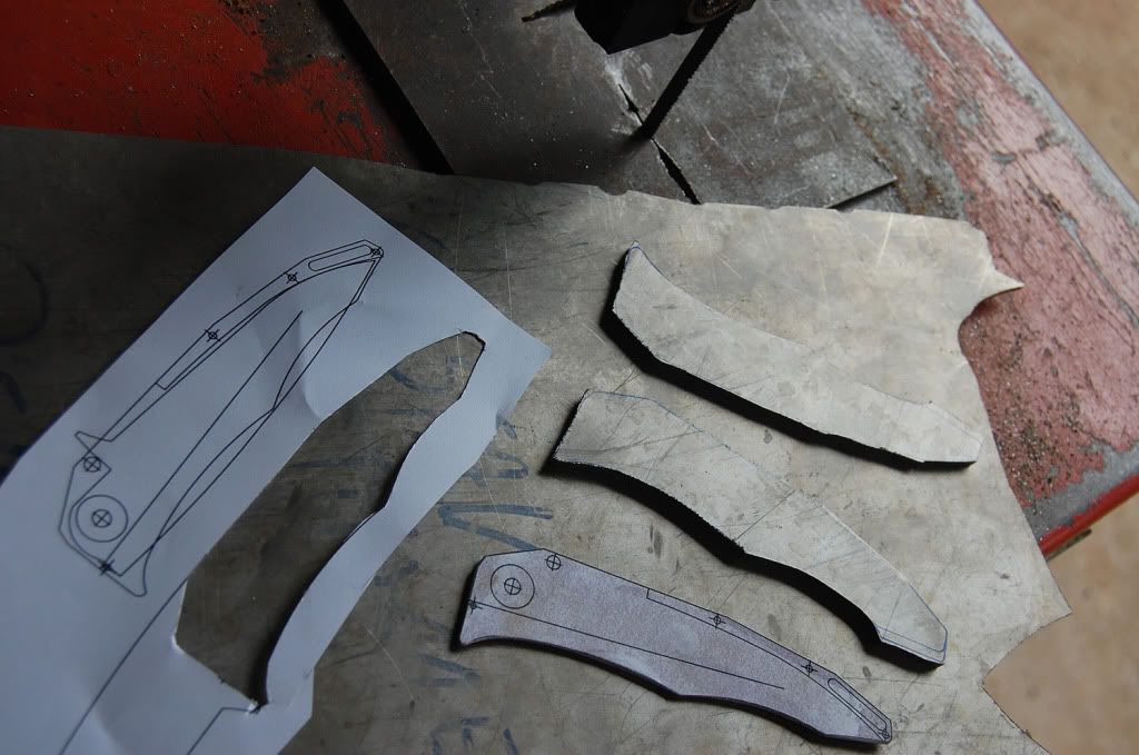

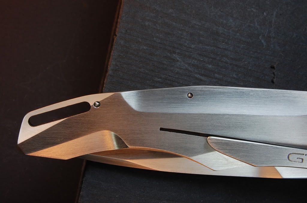

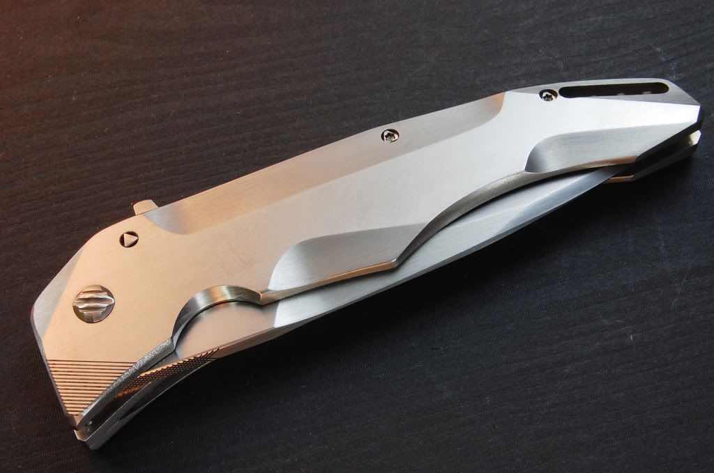

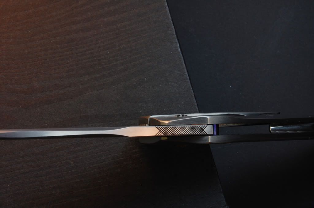

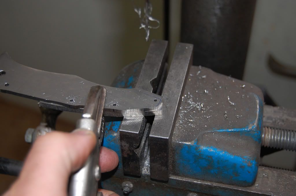

Finished this one on weekend. I used my framelock interpretation on this one, cutting the lockbar from the front part of the frame (the frame contour makes the 90 degrees to lock the blade). This help the making process a lot, there's no need to use a milling machine or send the parts to be waterjet cutted. Also, I had the idea to screw the clip on lockbar, making it remains flush with the frame when the blade is opened. So I've took some WIP and finished pics:
CAD drawing, templates, frame cutted:
Drilling
Drawing the lockbar limits
Cutting the lockbar
Lockbar working
Milling the "muzzlebrake"
Grinding the frame:
