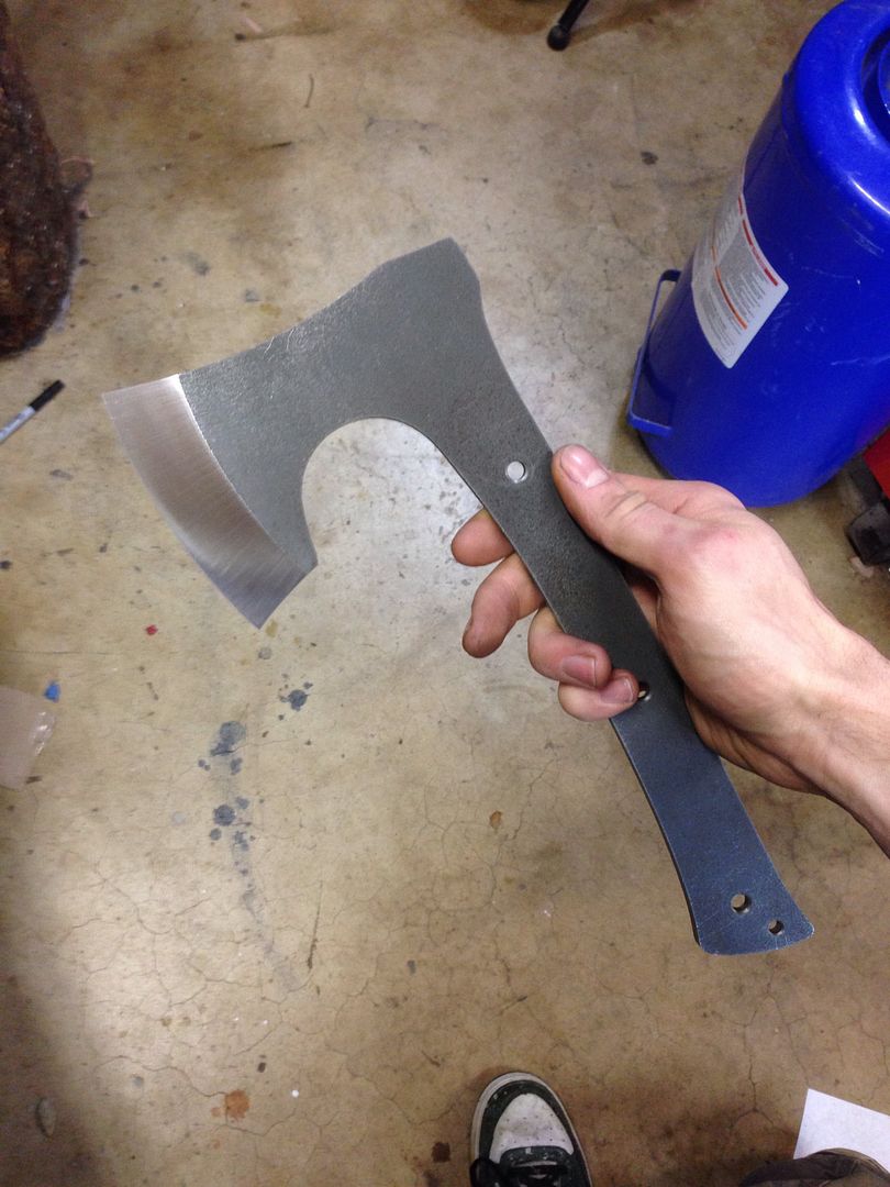

I finally am making some progress on these!
I designed these with hunters and bushcraft in mind. I have had lots of requests for a lighter axe geared more towards wood cutting than tactical purposes.
This version is made from all time favorite steel for toughness and being able to get scary sharp! L6. They are right at .220" thick.

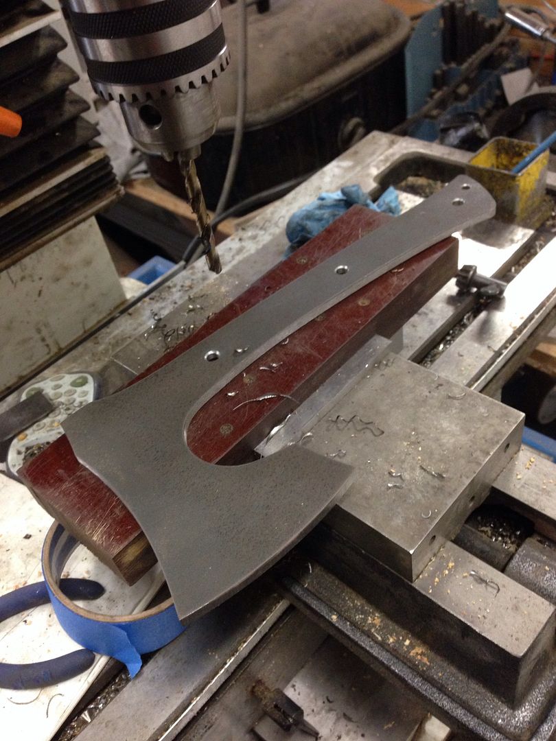

Drilling holes for the handle scales.

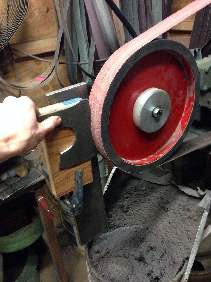

Cleaning up the profile on a super high tech work rest. : )
Rough Ground and ready for my heat treat!

I like the design. Not sure if I have ever seen a bearded hatchet before. Looks like it would be a fantastic chopper, although from the pictures it almost looks like the edge is hollow ground. Not sure about the longevity of such a grind for the application. Yet again, L6 is some tough stuff.

Thanks. It is flat ground like all of my axes and tomahawks.
Oh okay. The way the light reflected off of the edge in the picture made it look hollow ground to me. What color scales do you plan on putting on it?
