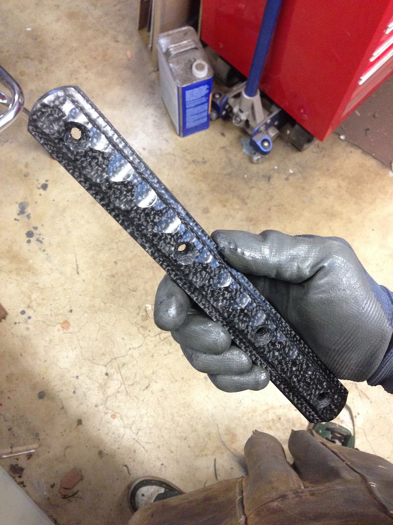

I decide to do something new for this model and mill "fullers" in the scales. I built a simple jig to clamp in my vise, and started cranking. I really need a powerfeed. : )
[video=youtube;-CtCT4LKPYI]https://www.youtube.com/watch?v=-CtCT4LKPYI[/video]
The end result. I will still round and smooth them out out by hand once they are attached.
This set of scales is for a custom order. Love the look of CF, just hate the itch.

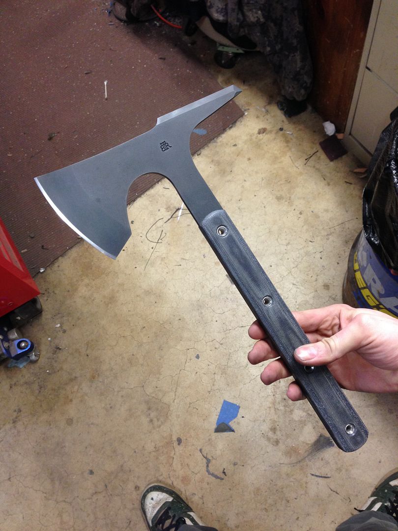

Here I am flaring the stainless tubes for a rock solid handle.
And the end result all finished up and razor sharp!
