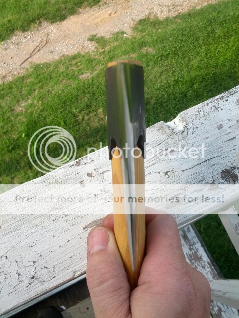

I have been reading this subforum for some time now, and decided that I needed a new hatchet. And like many of you, I want the best there is. It didn't take long to hear that Gransfors Bruk is to the axe world what CRK is to the knife world. My father and I are going camping in the Rockies in 3 weeks, so what better place to give one a go. Well, it came in the mail today - the Wildlife Hatchet. Smaller and lighter than I expected, but still I am very impressed. And underwhelmed at the same time. The edge of the bit is off center it seems, and I need opinions. Should I just keep it and use it, or return it to the place I purchased it, and exchange it? For $112.00 I expect a hatchet to be dang near perfect. I rehung a hatchet last week myself, a cheap one, and it's dead on straight. And that was the first one I've ever done! So how could this pass through quality control and not be noticed? Or am I just being too picky? Here's the pics:

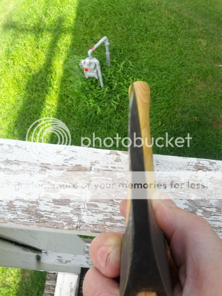

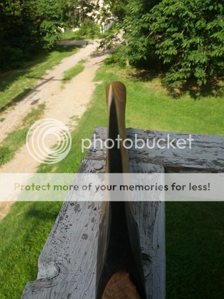

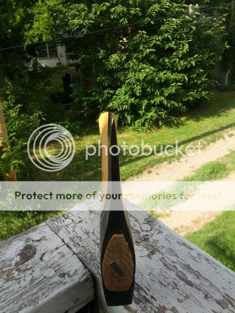

And here I lined up the bottom of the edge with the center of the bottom of the handle, to show how the bit is canted (or whatever it is):
So basically I would be striking what I'm cutting slightly to the left of perpendicular. Would this bother you if it were yours? I need some advice here. Thanks guys..
If I spent the kind of money that is required for a GB, Hell yeah it would bother me. Call em up and get it replaced. It will always bother you.
If you are unhappy then return it. The only way you can be sure to get a perfect one though is to find somewhere to buy it in person, or a retailer that will inspect it for you before shipping.
That said, I have a wetterlings with a very similar cant to yours and it doesn't bother me or affect performance at all.
It looks to be hung correctly, but the bit is out of line with the lugs and the rest of the head. I'd return it. It is kinda funny how particular we are about a top of the line axe comparing to a top of the line knife when you consider the cost difference between a CRK knife and a Gransfors axe. There's a few hundred dollars difference there. You could buy a Tuatahi for the price of a Sebenza.
I have seen a few YT vids of the forging process at the GB factory, and the actual forging process itself is no more than 3 or 4 minutes. CHeck it out if you haven't seen one..
Yeah, that's a head geometry screw-up on the forger's part. It would be different if the hang was bad, but this is much worse. Especially on a smaller axe, this will bug you to no end and mess up your precision. Send her back.
