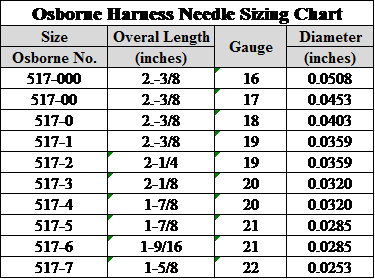

Any input on inexpensive groovers, and which size/type of needles I'll be needing?
If you are pre-forming your holes (whether with a sharpened awl, drill, or punch) you will want harness needles which have a rounded head. They are not sharp.
I use C.S. Osborne Harness Needles, sized 517-1 (size 1) and these tend to work well for me. You may find that you prefer a slightly smaller diameter (Higher gauge and size number) but I'd suggest that you try a size 1. I have some 517-4 needles which I feel are too fine for thicker threads and leather. I use 5 strand linen thread.

I hope this shows well in HTML format. . .
After a bit of research, here's a summary of the harness needle sizes offered by C.S. Osborne. Yet, the key is making sure that the eye is just large enough to accept your tapered thread.
Thanks for the information on the needles :). I am indeed planning on making the holes after the sheath has been cemented together, and then stitching it up after that, so the harness needles are exactly what I'm looking for.
