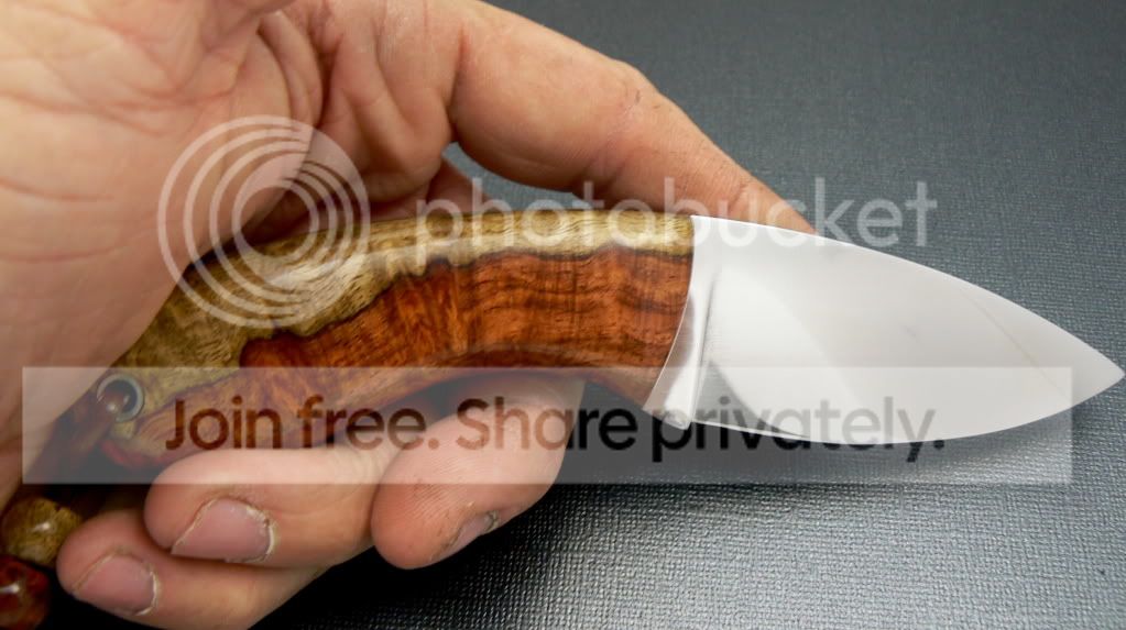

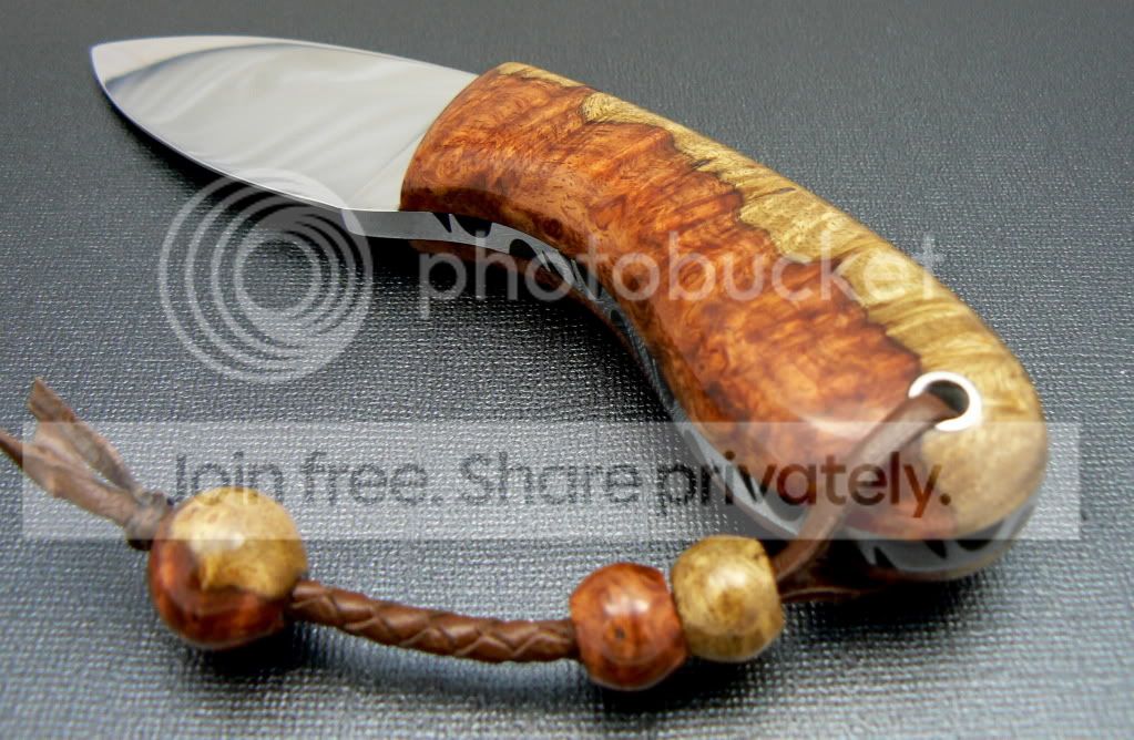

Anyways, Im working on another knife for a huntin buddy and on the first knife I had to patch a bunch of tiny air bubbles in my exposed epoxy around the filework.
Im wondering if you guys heat your epoxy in the microwave or something. I would think that heating it would cause it to cure too fast or something strange and violent, but I cant think of any other way to remove the air bubbles.
Can I do anything to eliminate them?

You will find that using a slow cure epoxy will solve the problem. The best way to eliminate the bubbles is to not put them there. Fast cure epoxies with all the peroxide accelerators, and whippig in air when mixing are the two biggest causes.
Get a good quality 24 hour cure resin. West system, System Three T-88, and Accraglass are all good. After mixing ( slowly) and letting the pot set for a few minutes, the bubble situation is virtually eliminated. I give the pot 2-3 seconds (yes, seconds) in the microwave to thin the viscosity if pouring into hidden tang holes, but normally just let it sit for five minutes before buttering the scales.
With a 24 hour cure resin, you have an hour of work time, and three more hours of set time to clean up, so rushing is unnecessary. The bonus is the slow set resins also have a much longer shelf life.

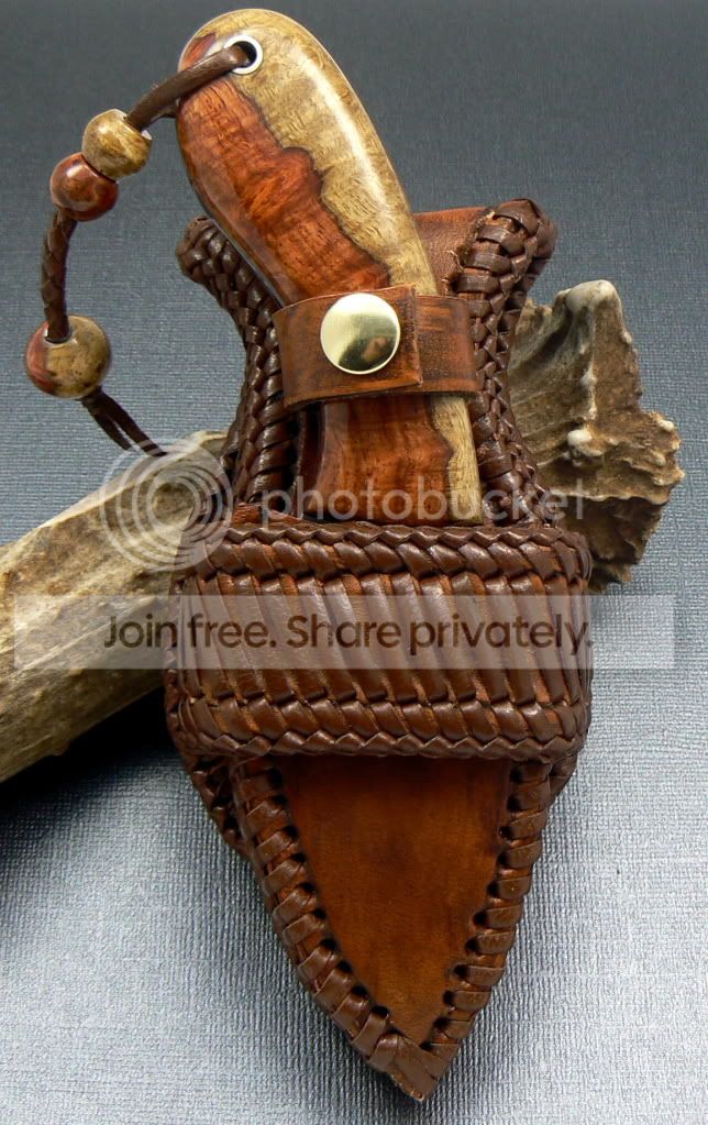

That's a very, very impressive first knife! It's clean and has real nice overall lines. Well done! :) :thumbup: :cool:
I can't add anything except that's a gorgeous knife and sheath. :thumbup:

Try running a soft propane flame quickly over the epoxy surface.
It will heat up the air inside the bubble, the bubble will burst, then level out.

The wood above is from a block of Amboyna burl that was half sapwood and half gemwood(correct terms?) from House of Burl
Awsome looking knife and sheath! I can only hope when i get my first knife done it looks 1/2 that good. I better get back at it :)
Is that your first knife in the photo? If so, wow! That looks great. The filework looks great, get some west system if you plan on doing a lot, it is one of the best brands and will probably be less problematic.
One thing I do when doing a small or large epoxy project is take my epoxy cans and put them in an electric skillet set on the lowest setting so when I dispense the two parts they are already warm. Since epoxy is exothermic I don't like heating it after mixing. A habbit of mine from doing large area lay-ups is to always mix my epoxy in a cup then pour it onto a large flat surface to help it dissipate the heat better and give a longer pot life, I.e. let the air bubbles come to the surface. I buy my epoxy by the gallon because I use it to repair my race boats as well, so it comes in metal cans and works better in the electric skillet. I don't know how well it would work for small plastic bottles but you could always try putting it into small dishes of very hot water.
Warming any epoxy will cause it to kick faster. It may work but you take a chance of the bubbles getting trapped because the epoxy 'freezes' to fast to let them escape. Try adding a SMALL amount of pure acetone. This will thin it without the heat and give the bubbles a better chance of escaping.
Experiment with adding acetone before you use it on real projects. As mentioned above, stir it slowly.
