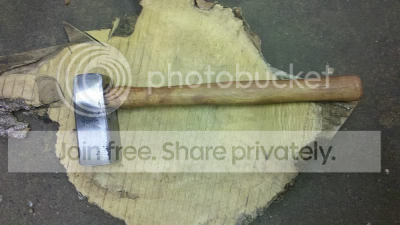

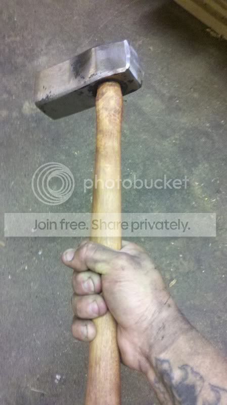

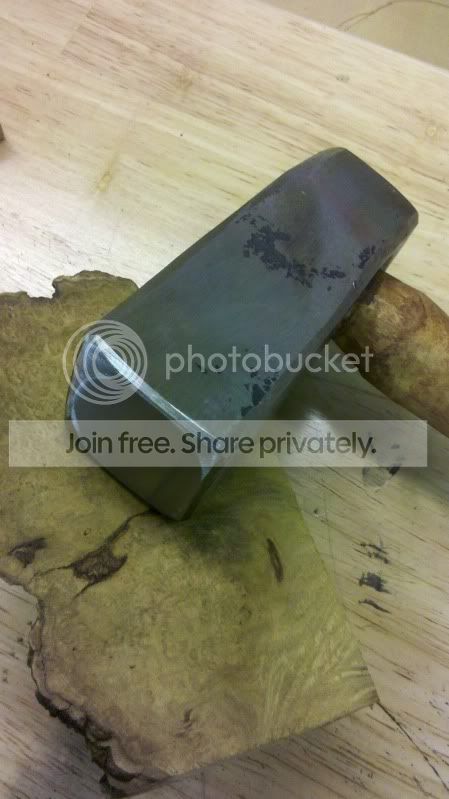

the last time i was up at Delbert Ealy's shop, we forged out a hammer head. After it sat around in my shop for 2 months...I decided to actually make a functioning tool out of it. I ground the face flat up to an A45 finish, So is the main areas of the body. I made the handle out of some nicely grained Honey Locust...not like i have a shortage of that stuff. The piece of steel used is 4140, heated to 1500 then quenched in AAA Quenchant and draw tempered to what i believe is about 52rc. Handle is sanded to a 400 grit finish and coated with several coats of Tung oil and leather dye.
Anywhoo
Sorry about the level of dirt covering me....Cleanout day in the shop.

Feels good to have it ready! Ryan, i did the whole handle on my KMG. I don't have a wood lathe....yet :) Forgot to add...She is a beast, tipping the scales at almost 5lbs on the dot. Shouldn't have any issues moving steel with it :)
