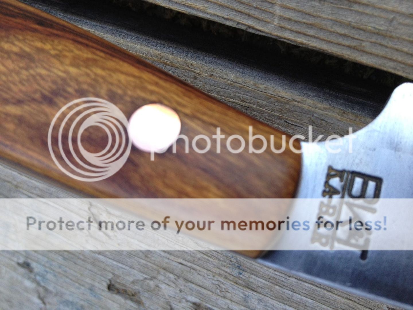

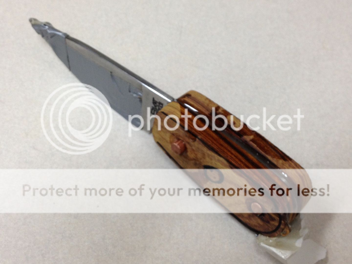

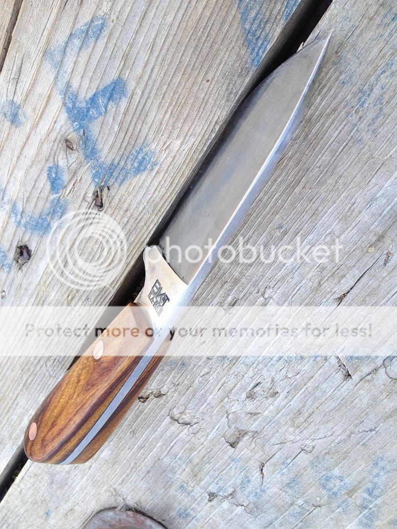

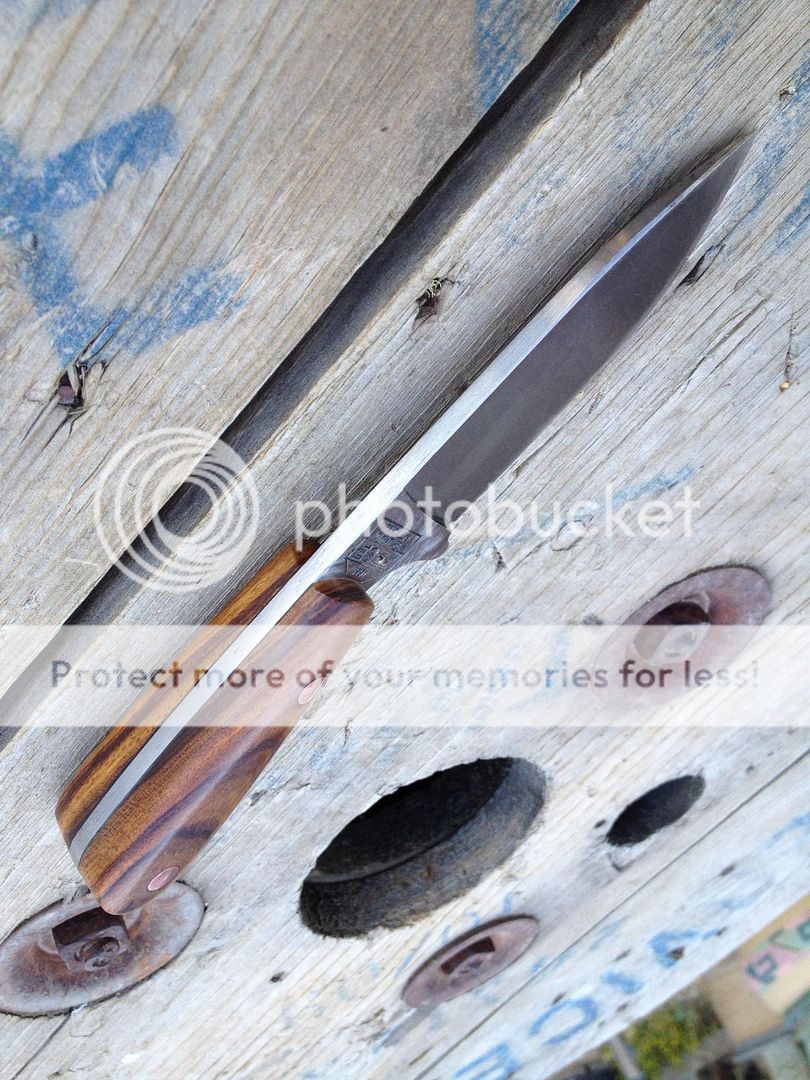

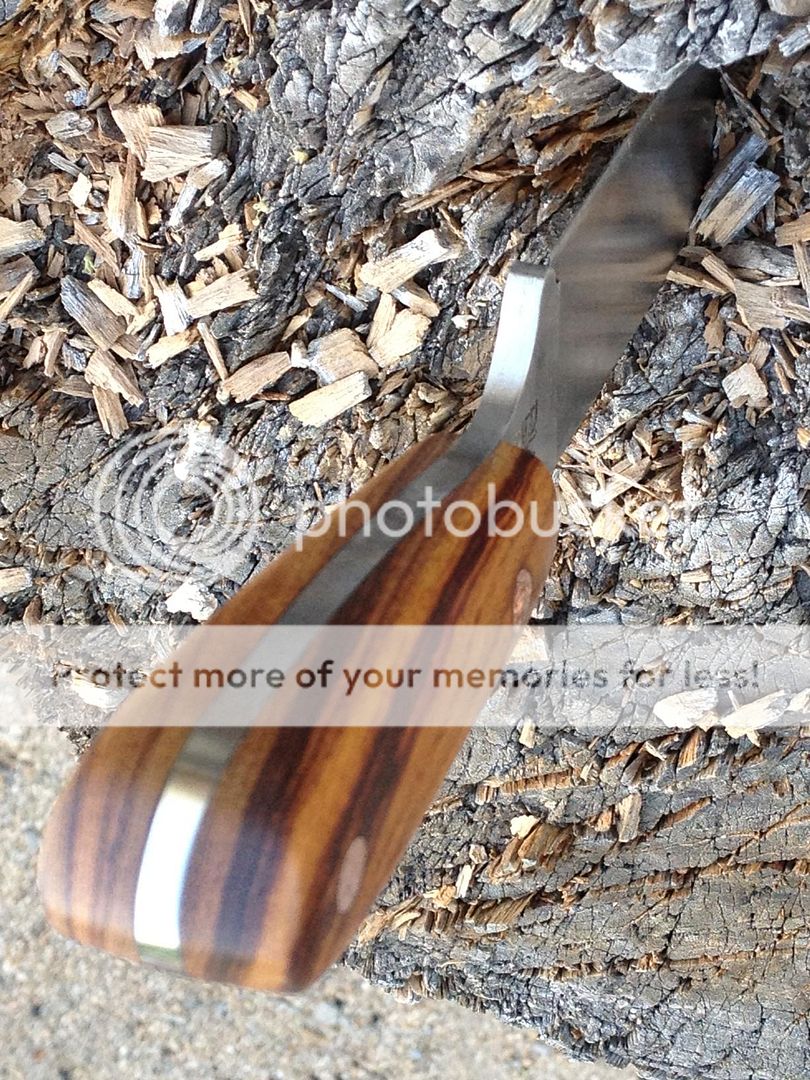

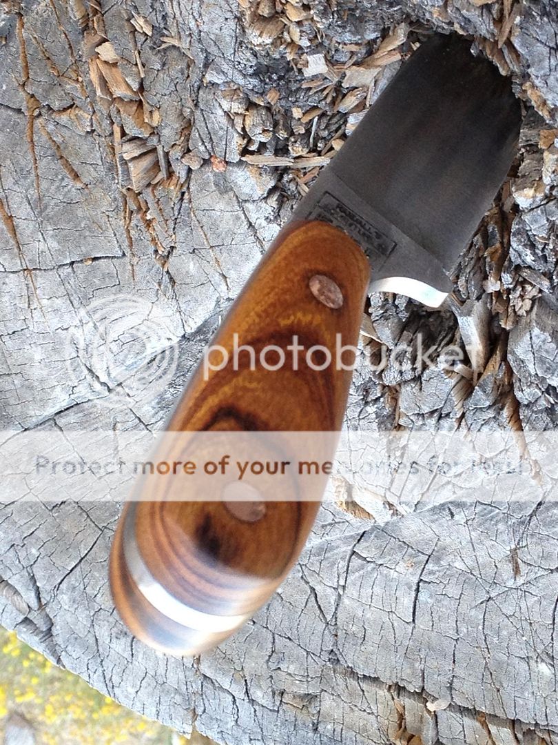

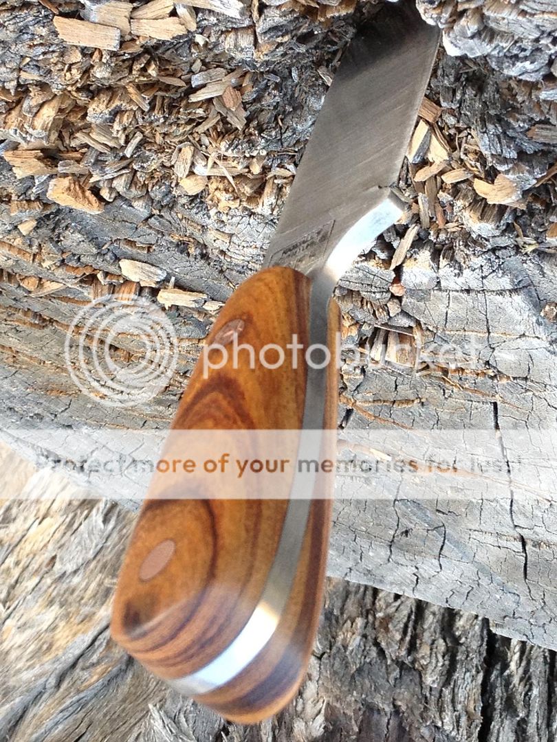

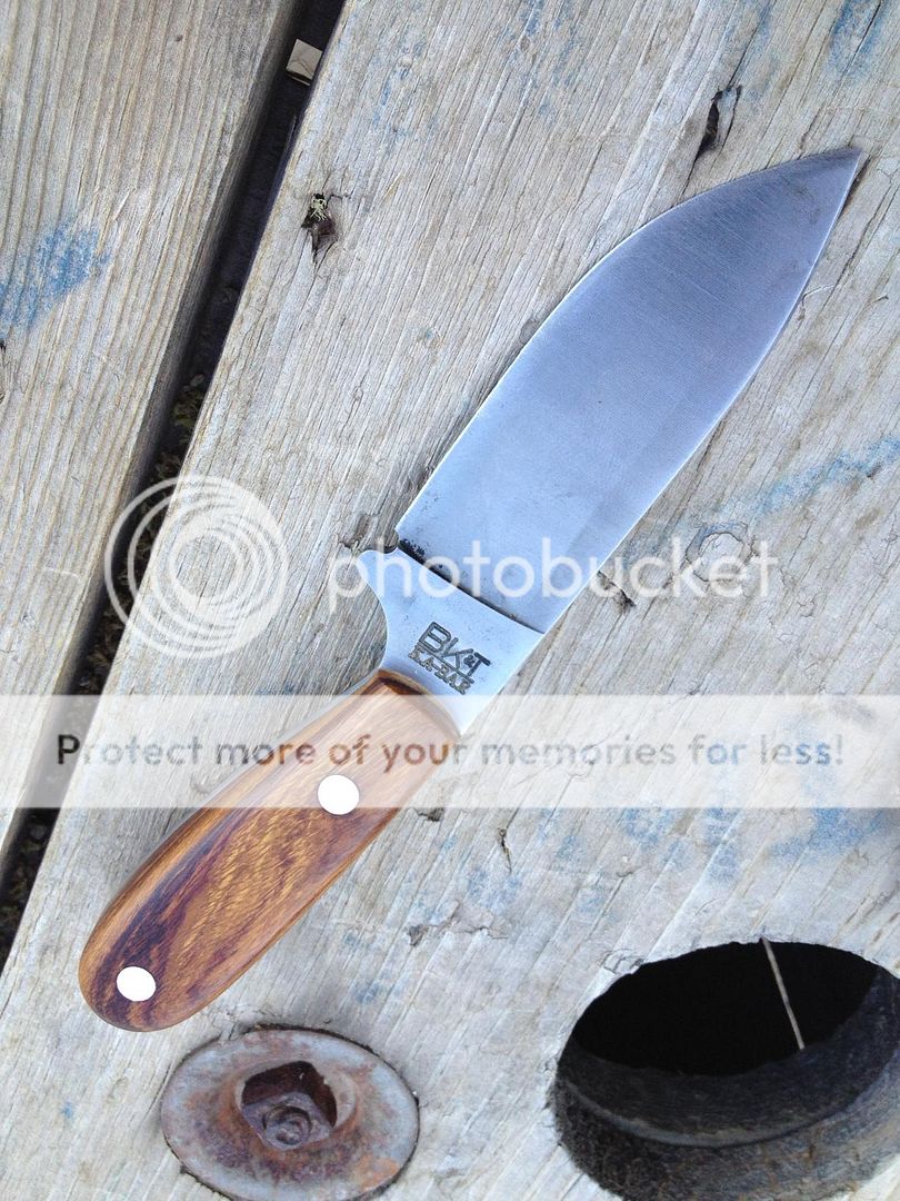

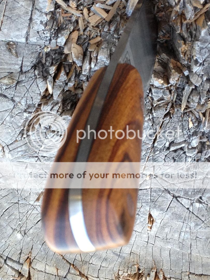

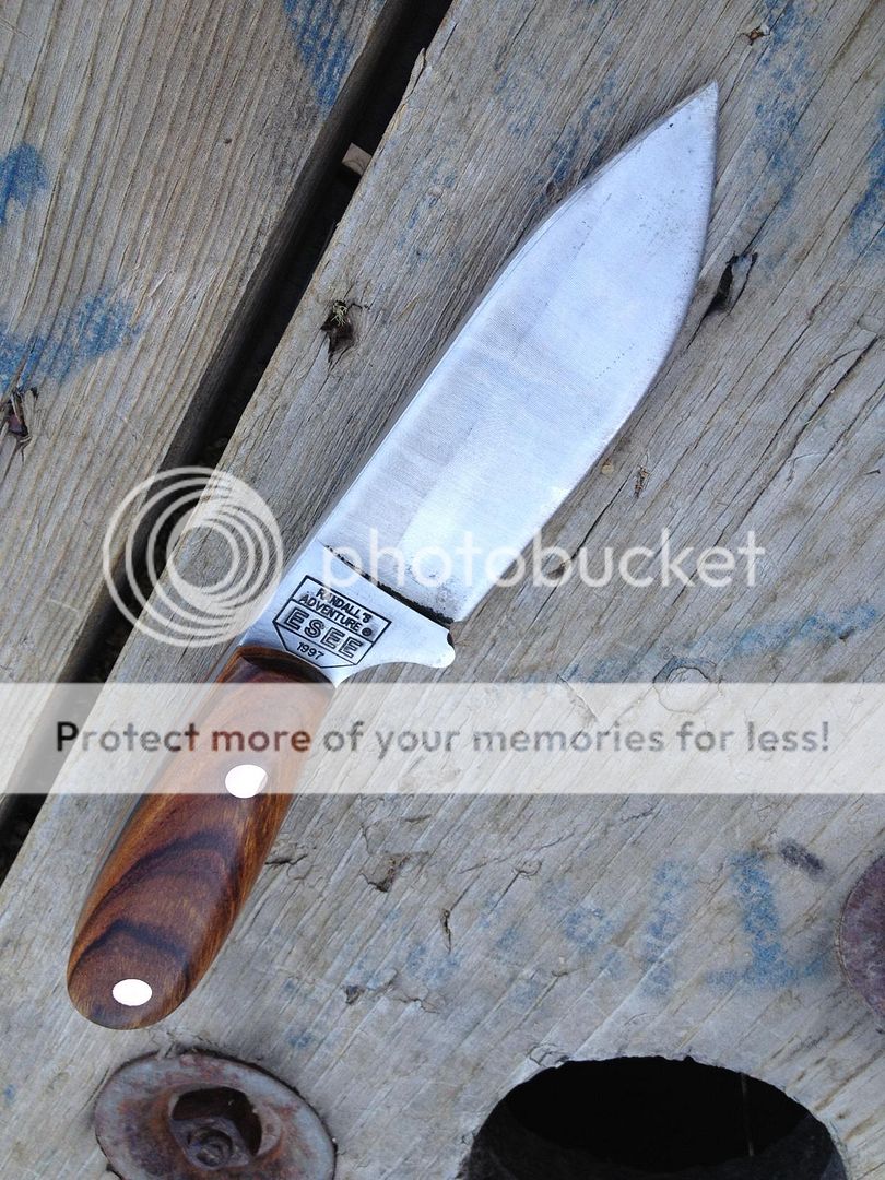

One of my BK 14's has been sitting in my boat for over a year, no use :( no handles either....
I stripped it and convexed it, then I put it in my tackle box and almost forgot about it.
I did the usual Desert Ironwood/ copper combo...:)
A few more :) She makes me happy :)
Nice job Sir!! Although I will say, for me, the handles appear a bit too wide for my grip. But I really dig your craftsmanship.

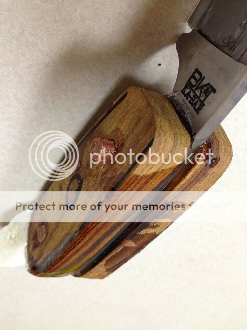

Did you have to put anything inside the skeletonized area in the handle to keep the scales steady?
That was the tricky part. I did not use anything in the skeletonized area, to hold them in place. I drew a line around the handle so I knew where to place the knife. I built up blocks as a jig of a sort, so I could lay down the first scale, epoxy it. Then I epoxied the pins and set them in the 1 scale that was down. Then the knife, then more epoxy. Then I put epoxy on the second scale and lowered it down the pins to sandwich the knife. All this while making sure the knife didn't move. I also had the whole assembly hanging off the edge of the jig enough to get my clamps on without moving the whole assembly while clamping in place.
I did a few dry runs to test it out. I was worried it would move and my pins wouldn't be centered.
Beautiful work my friend. You should be proud of those.
