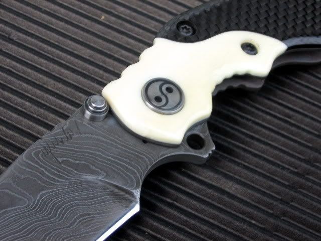

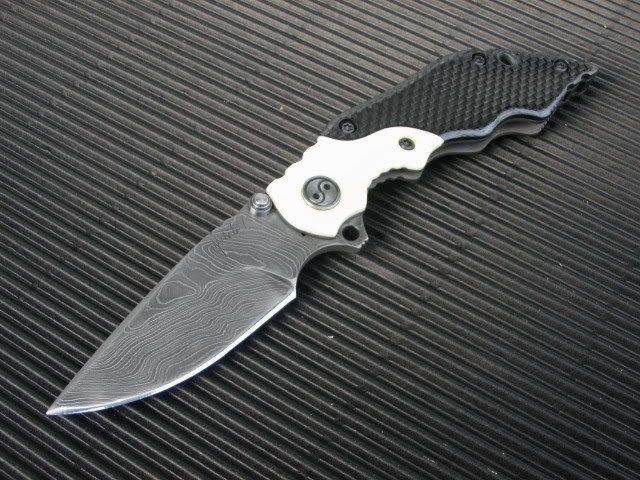

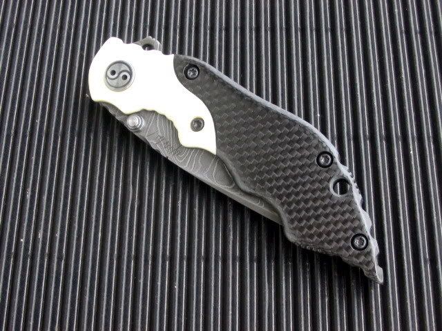

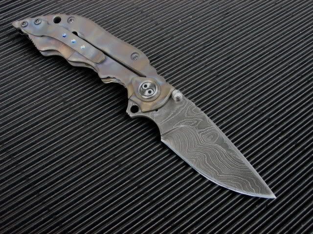

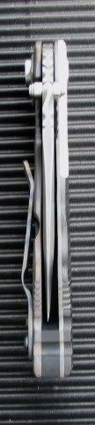

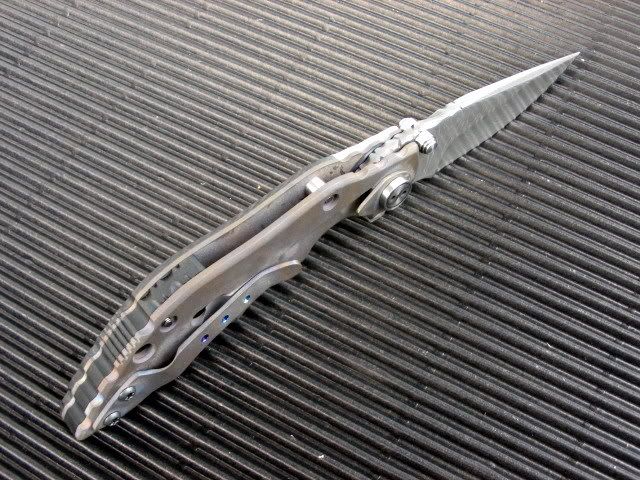

Hi all guys,
Just finished! The new blade style of my HARD series. :)
Thanks for looking. :D
YUN
I LOVE that!! I love drop point blades. Heck, I just LOVE all the knives that you make!!
Thanks for all kind words.:)
Spec. is;
Blade steel - Alabama damascus, 4.5 mm. thickness.
Blade length - 4" ( tip to flipper ),hand rubbed satin finished , 1 3/16" widest
Closed length - 5 1/2" length and widest 1 1/2"
Handle matt. - Elephant ivory & carbon fiber
Lock system - 6AL 4V titanium frame lock 1/8" thickness and thumber stop
Frame, spacer and clip - Sand blast&hardened 6AL 4V titanium
Frame stop - 6AL 4V titanium
Pivot screw - Hardened 440C in Yin-Yang style
Thumb stud - Hardened SUH 3, this steel is valve steel in diesel engine.

That makes it seems even more amazing! the combination of old-world materials with newer hightech materials really creates an interesting piece. WOW!
Fantastic knife !! I still really wish you could redesign it without a choil and get more cutting area in the blade as 5 1/2 is a lot of handle.
