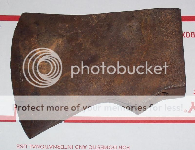

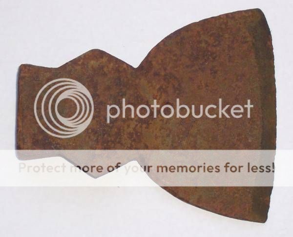

Found these two recently - top one is a Jersey-style head. No markings on it anywhere. Blade has a couple chips but nothing too bad, the pole is flawless - almost looks like it never struck iron in it's life. Bottom head is a long blade, very rusty but the pits aren't too deep. Once again, couple small chips in the blade, pole has some chips as well but they are small and no cracks I can see. Only marking is a small, sideways "S" stamped into one side of the face very deep-like.
Any info you guys can provide of these axes' makers is appreciated, or info about their design or rescue-ability. Eager student looking to get schooled.
I think they're all pretty good to rescue! :) That bottom one is possibly a hewing axe...is it beveled to one side? The top one is in great shape...are there ridges in the eye?

That Jersey looks great and I'd guess the chips are minor. Many of us just dunk the heads in vinegar and let it do its thing on the rust - couple days and you have a clean axe. The hewing hatchet is pretty rusty so it might want to soak longer. Wire cup brushes on the angle grinder or bench grinder wire wheels are also good. Nice thing about vinegar is that it will help remove scale from inside the eye. It's not vital but in my brain it feels right to get rid of it if it's heavy. Youtube can hook you up on videos to watch.
It's not beveled, looks pretty straight to me. The Jersey head does indeed have ridges in the eye. A very stout head, and heavy, I'd say 4 pounds.
Lots of blade left on the Jersey and very little disproportionate wear at the toe or heel. Rare to find a 'poll' (not 'pole') that hasn't been deformed. That profile has a generous eye (unlike Hudson Bay patterns) for haft contact and ought to give you lifetime service and durability after it's carefully hung. One day I'll find one of those around here and give it a shot but seems like Dayton and Michigan are the mainstays where I am.
Interesting. The Jersey may be a True Temper of some sort, as the conventional wisdom seems to be that many (but not all) of the unmarked, ridged eye axes are possibly True Tempers that came with paper labels. There were, however, other makers who utilized ridges as well.

After looking at the broad axe a little closer, it does indeed have a very slight curve to it, to the right. The right side is a bit more flat, so the left curves around to the right, but it's real faint. Maybe it is a hewing axe.

Well, I put the axe heads in the vinegar bath for a few days, wanted to share the results so far.
The Jersey axe head is not only clean, but amazingly sharp now since the rust along the edge has been removed. The pic shows a darker area toward the edge, than the rear of the head - that's not moisture, the head is completely dry, so the darker edge portion of the head I believe is a result of the vinegar having a different affect on the hardened part of the axe. Very interesting to say the least. Most of the rust is gone, the few spots left will be cleaned up with the wire wheel, before repaint. Yes, I am a firm believer in painting re-hung hammer, and now axe heads, mainly because 99% of the time my tools are stored outside in a non-climate controlled environment, and I hate rust. So while they are in storage, they will at least have a protective coating of paint to keep them nice and rust-free.
The Jersey head:
The hewing axe head didn't fare as well - the lighter rust on the exterior of the head was removed, but the heavier pitting and dense rust was unaffected by the vinegar. I'll have to put it on the wire wheel and see how much gets removed, and then maybe try the vinegar bath again.

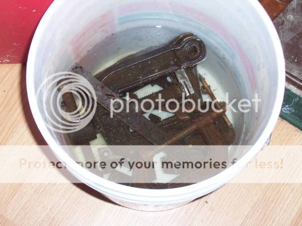

Here's some more items I'm playing with at the moment, cleaning them up in a 5-gallon bucket of vinegar. After I day of soaking I take a toothbrush to them, see how many have to go back into the bath some more, and the ones that are good will be either coated with paint or with Johnson's Paste Wax. Here's a old pipe vise, an Armstrong C-clamp, an old Ford wrench, and a Craftsman combination square all taken apart and having the vinegar do its stuff.
I like those plastic scrubby things or even red scotchbrite because after the first soak, the scaly rust knocks off pretty easy, then the vinegar only has to deal with the pits. If it is reeeeeally scaly, and that hewing axe certainly looked like it, you might have to get into power tools unless you have plenty of time on your hands.

ETA: You are right about the hardened steel up front. Just out of curiosity, I dip heads in vinegar just to see what that portion looks like even when the head appears to be in good condition. It will eventually show up on your hewing axe too.
