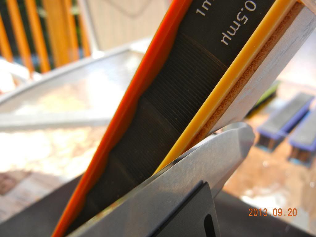

New XM-18 owner here....3.5 Spanto. Received it with what was claimed to be the factory edge...this looked to be true (appeared unused), but ranked as the dullest blade I own so not sure if it was accurate. Sharpie and EdgePro put that edge at about 24 degrees. EdgePro gave it a much better edge, but still not a slicer by any means...may be the nature of the thick spanto blade(?). Would you discourage regrinding to a steeper angle for a 'sharper' edge?
You measured it out and it came up *24, that sounds right. You can get that bevel angle sharp enough to slice paper cleanly with no problem, no need to go more acute. Just stay with it and/or strop it.
Apparently it was a "used" factory edge as they don't come dull from the manufacturer.
The knife isn't that thick behind the bevel that you can't sharpen it (23 or 24 degrees) and have it cut very well. A properly sharpened spanto/slicer/wharnie/etc. will do most cutting chores just fine. But, these aren't super thin slicers, these are working knives, designed favor robustness and durability versus a fine kitchen knife.
24 degrees and finished her up with stropping seems to be very good working edge and will push cut paper.
Many thanks for all the helpful input. Though my edge is much improved from the way it started, I still think it needs some more work on it based on what I'm reading and seeing here. Back to the water stones! Thanks guys.

A bevel angle of 24* per/side is not the reason the knife "won't cut". The knife won't cut because it has been dulled
With proper sharpening the XM will perform any and all cutting duties to include push cutting paper , arm shaving, etc.
Please don't (or strongly consider before doing so) take an XM to the bevel angles alluded to. 22*-24* is fine and can be made very very (scarey) sharp.
Your XM is made to provide a lifetime of service, don't change that by the unnecessary removal of blade steel that you can never get back.

No, it was dull when I got it and my first sharpening was a HUGE improvement over what appeared to be an entirely unused blade (though I have no real way of knowing that). I'm sure it didn't come from the factory that way based on his reputation. I did take it easy on that first sharpening, starting out with a 400 stone assuming the basics were already there. Well, last night I went back at it with the EdgePro, this time starting with a 220 stone and making the full spectrum progression up through that 6000 mirror maker tape. This improved on my first efforts to the point where it easily slides through paper now...and, yes, I did keep it at the angle it started at...24 degrees. Just needed a little extra initial effort on the sharpening to get it to pop. Thanks again for all the input here!
