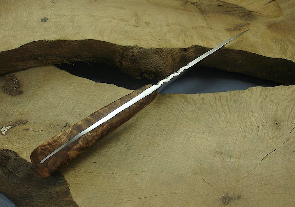

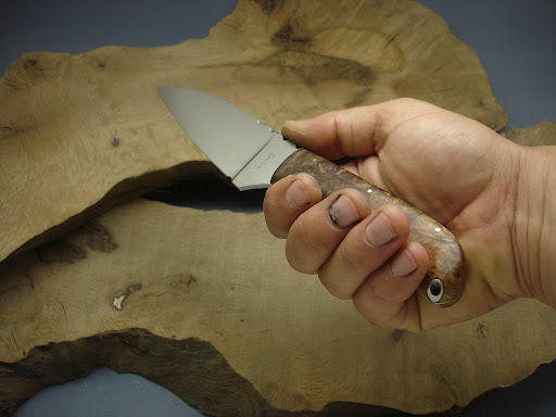

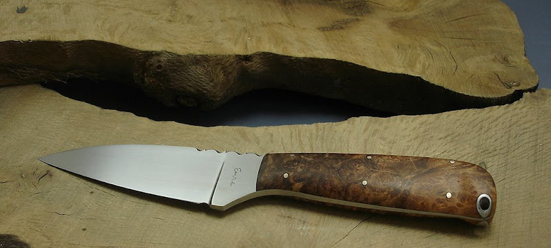

I'll be making a sheath for this one, however it was sold a month ago at the profiling stage. It is going to the husband of a customer whom I did a paring knife for her: http://www.bladeforums.com/forums/showthread.php?t=644973
Specs of this hunter:
1000 X hand rubbed, very thin flat ground RWL34 ~58-59 HRC blade steel full distal taper. Stabilized Maple Burl handle, SS304 pins and lanyard hole (a new design of a lanyard hole for me, it needs some tweaking but overall I liked it so much). This has a good polished tiny edge, pops hair with a touch. I guess he will like this...
Hope you like this one. I've got to clean my shop now, beginning to cut a new batch tomorrow...
