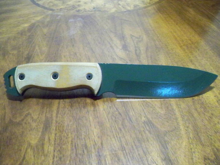

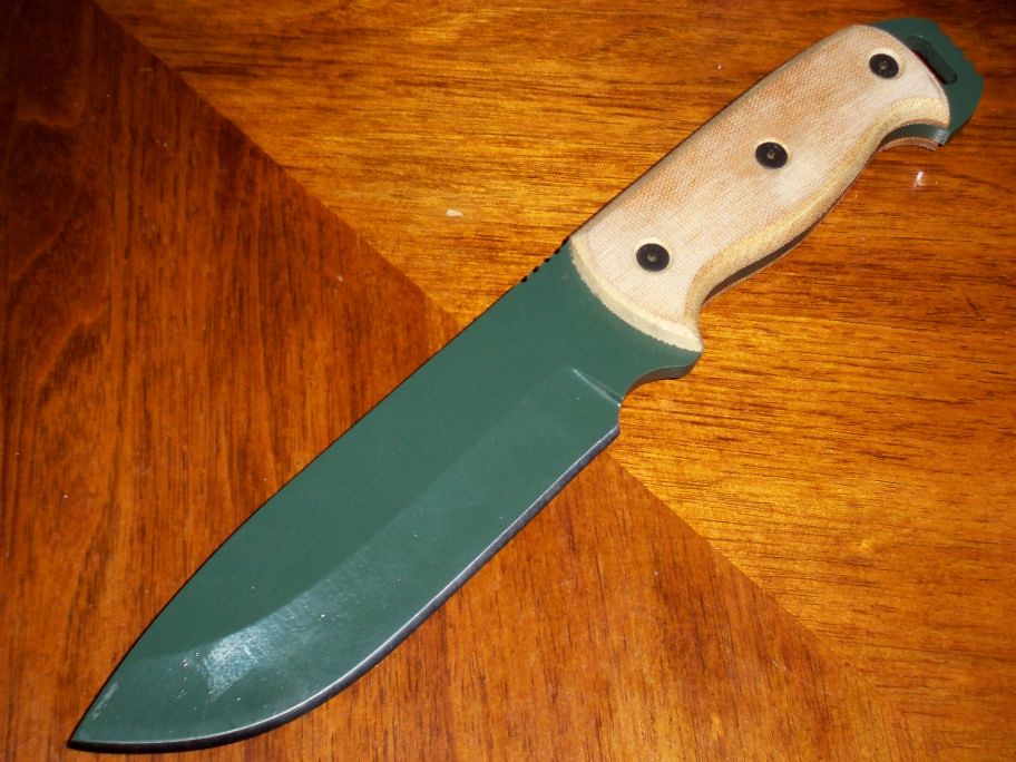

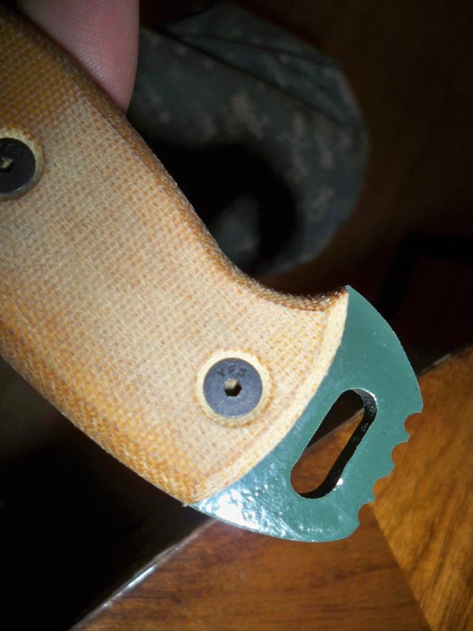

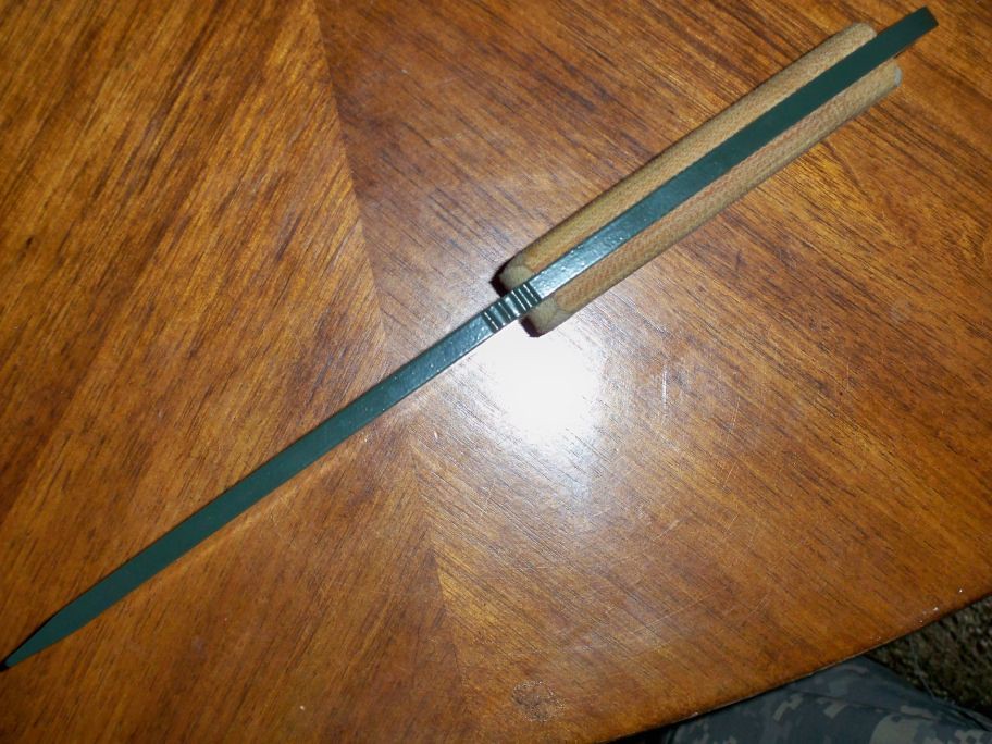

The knife is made out of a 1/4" piece 5160 steel, has a 1 3/4" wide blade that is 6" overall length from the tip to the begining of the tan canvas micarta scales (so it is a perfect fit with the spec ops combat master sheath) and has an overall length of 11 1/2". It has been heat treated and triple tempered to 58rc and finally finished in OD epoxy base powder coat.
When I was speaking with Justin I was very specific with what I was looking for and he did not fail. I told him I wanted the spine of the knife to be straight all the way from the blade to the pommel as opposed to a more contured palm section of the knife, I wanted a saber grind and lastly a pommel like those found on the newer Ready deployment knives as well as the ones from ontario knife company.
Now last but not least the pictures:

Awesome blade!Reminds me of a BK2 or an ESEE 5.
pretty close, when I told justin what I wanted in this knife I was really hoping it would end up looking like a cross between a rd6 and an esee 5, he accomplished just that.

one intereting thing about the knife though is the more obtuse angle to the edge allowing for a chopping/ prying edge that will be harder to wear out, I don't know if it'll be sharp enough for all I need it for just yet but once I go through training with it I should have a good idea whether or not it'll need to be a little sharper (though I suspect not). If I do need it sharpened though, sharpening is free and all I have to pay is the shipping and handling. Definitely a good guy to work with A++.
seems like you could have just bought a bk2 and some micarta slabs.. or got an esee 5... and saved yourself 175 or so... dont get me wrong its a great looking blade i just dont see the design as something that would need to be made custom...it does look like a work horse though
True, it was by most peoples standard minor differences between this knife, the bk2, esee5 and an rd6 but it was worth it to me to spend the little extra to get exactly what I was looking for.
