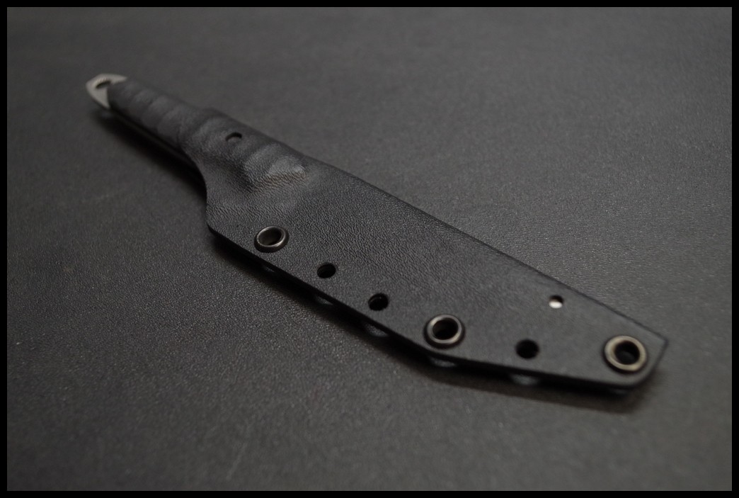

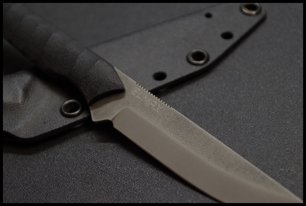

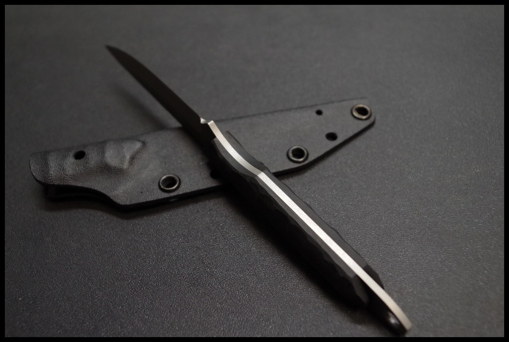

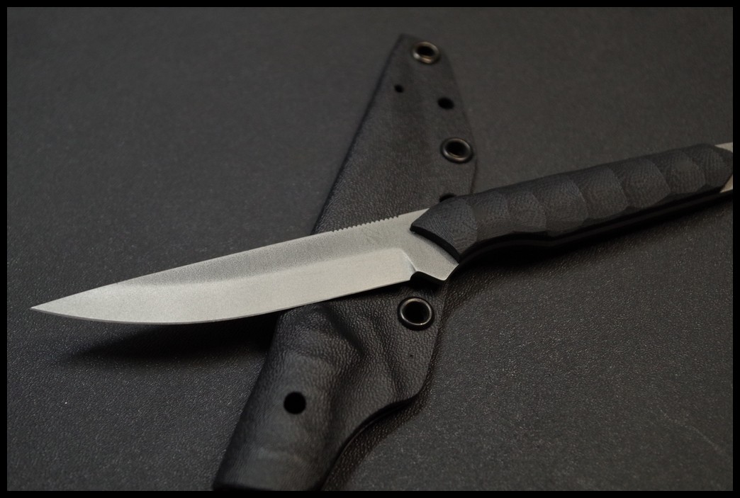

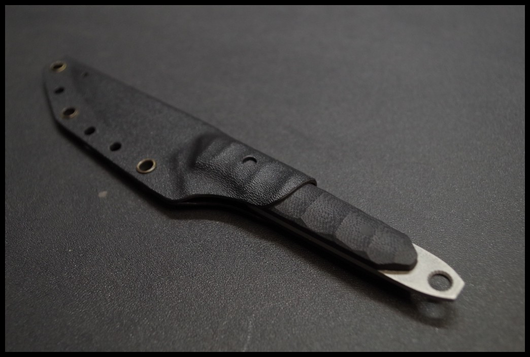

Hello,
From some time I was working on old design "Hunter", and also that knife was ordered by a one client.
Now I trying to refresh this design.
Here he go :)
Blade: 90mm
Whole lenght: 205mm
Bevel: 10mm
Thickness: 2,5mm
Steel: Uddeholm ELMAX ( ~60HRC)
I will work some more on this design, and will be put into standard offer :)

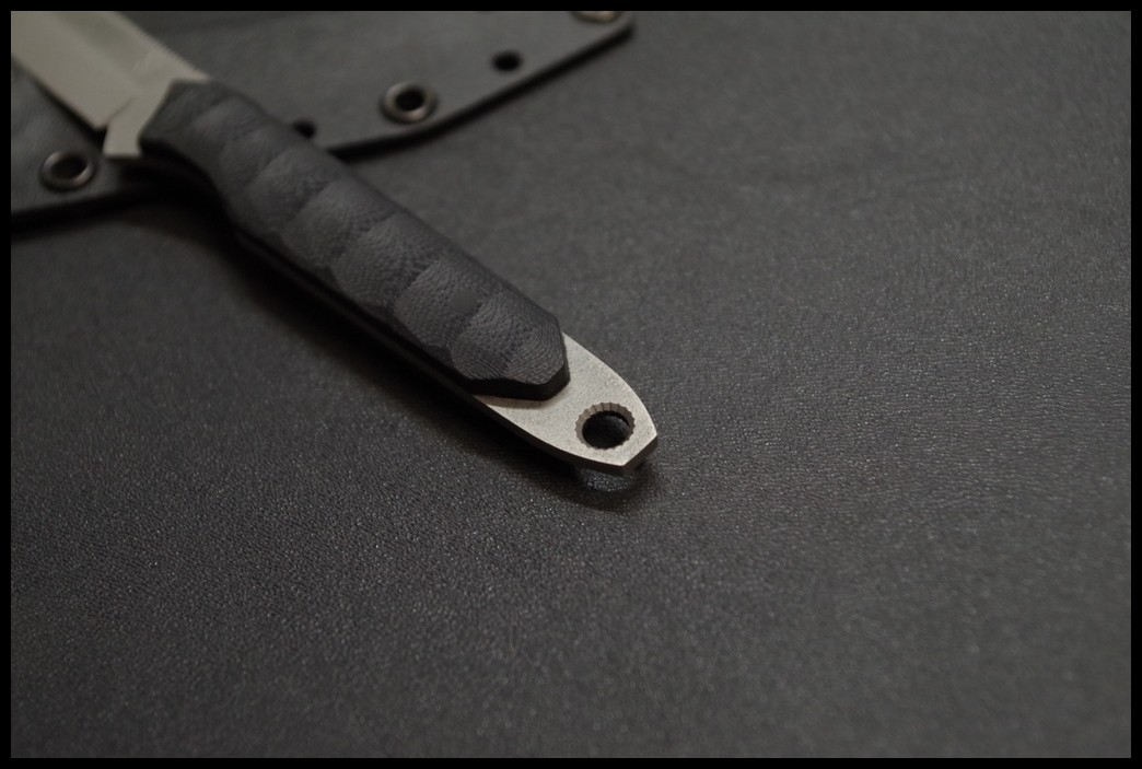

no pins? did you just epoxy or use and adhesive to bond the scales to the tang? just wondering this may be something i start doing to my forged knives. since they are usually to hardened after the forging process to drill holes into with norseman bits
He is using pins that match the color of the handles. If you look closely, you can see the outline of the pins 2 "divots" in from either side. If you check the exchange, people do it occasionally.
Nice knife man, I really like it. The checkering on the lanyard hole really is a cool detail. Good job :)
