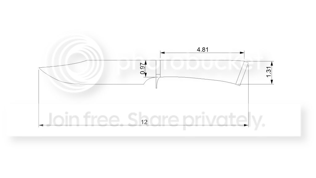

The knife started out as a basic bowie styled camp knife made with 13/64" 5160 steel. I had it cut out and roughly profiled when I had my wood problem. It looked sort of like this at that time.

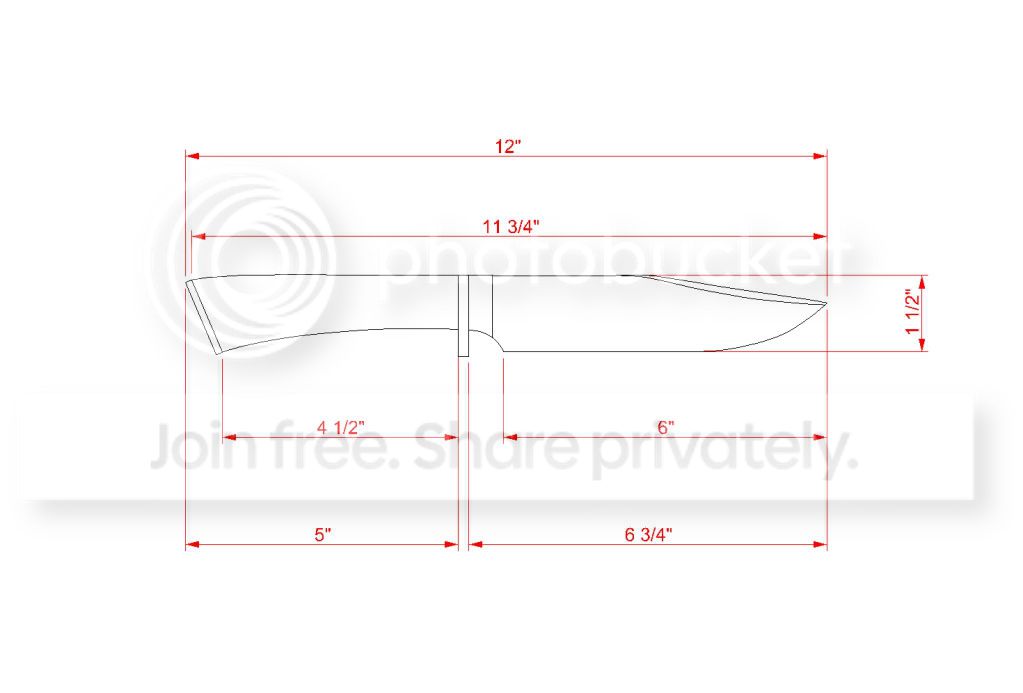

I rough ground out the bevels, and after looking at it over the next couple of days I decided that I just wasn't happy with the over all profile. So I painted it up with some layout dye and started tweaking the shape a bit. In the end I had something like this.
The shape from the guard back stayed the same, but I moved the start of the clip back about 1/2" and the tip down 1/8" and instead of a curve I drew a near straight line. I also rounded the transition into the clip just because I think it gives better flow to the knife. I jumped back on the grinder and made the changes and added a bit of a swedge, as drawn. All in all I think that it gives a lighter, more agile appearance to the knife. When I laid the blade on to my modified drawing I had hit every line almost dead on:eek:

I agree that clip in # 2 flows better
but
I like the shaped guard you have in the version 1 better than the flat guard in version 2
I like it unky:thumbup: I like the false edge in the second one.....a LOT!!:D That should turn out really nice. Can't wait to see some pics as it progresses.

I like the new improved design better than the first one. I'm glad the wood will fit nicely into your master plan.

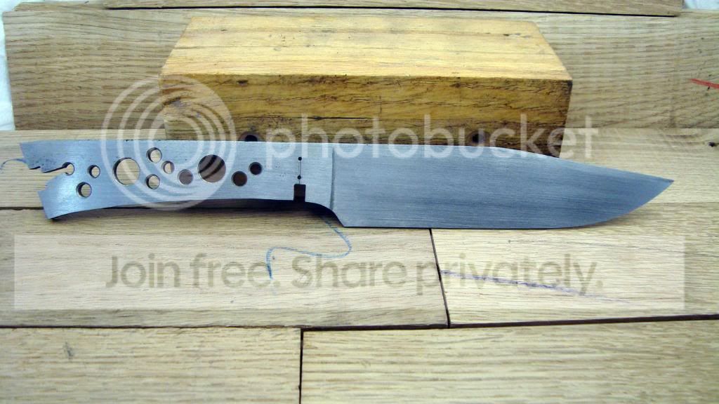

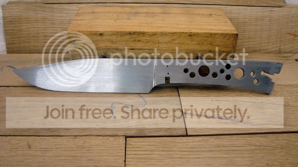

So here are the pictures of the state it is in right now. I still have some minor shaping to do and a lot of sanding:( The false edge barely show up in the pictures but the line is crisp and not washed out. It is just my poor photography skills and bad lighting.
The blade looks fatter than it really is for some reason, I blame that on my picture taking skills too. I still need to round out the corners of the guard cut out and the keyhole fr the threaded rod that will hold the pommel on. balanced is front heavy with the guard and pommel in blade, but once the scales are in place the balance point will be just behind the guard
I think it's coming along nicely, Unky:thumbup: I especially think you did a very good job getting the odd shaped cuts done in the tang to accept the handle/guard/pommel hardware. Very good work!
