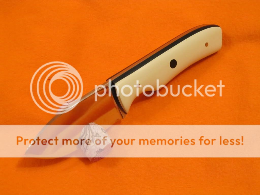

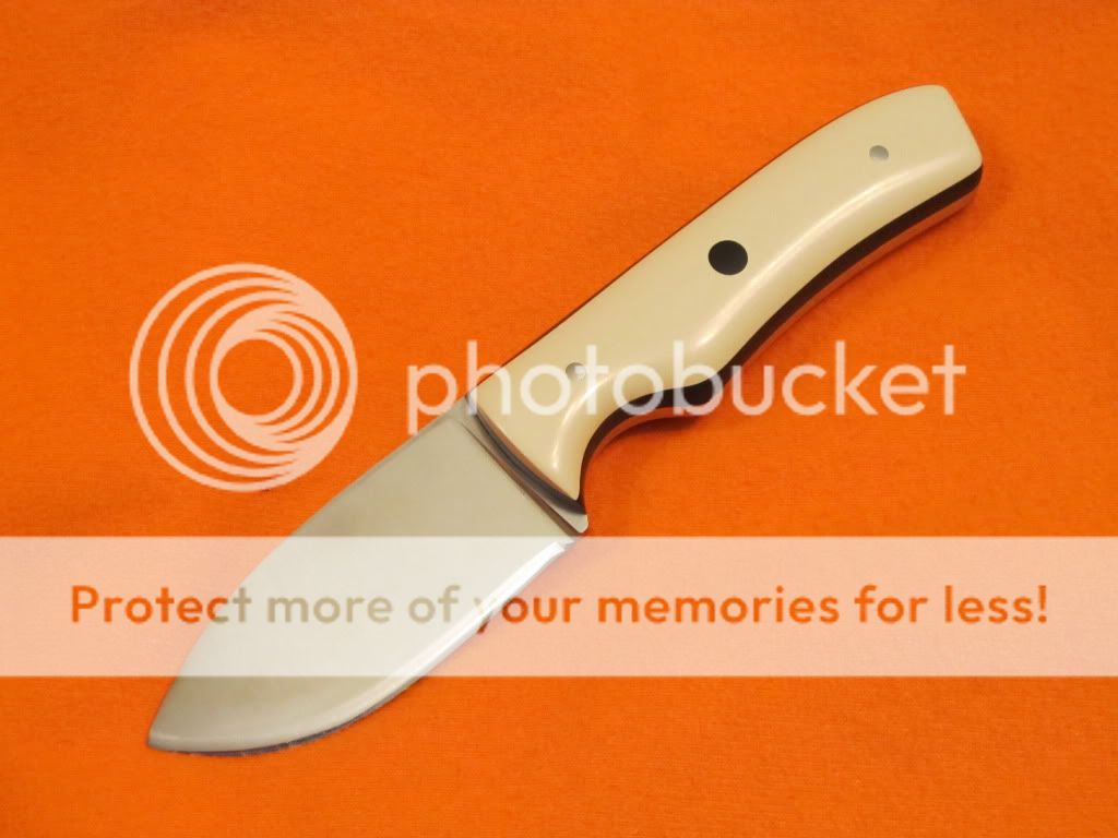

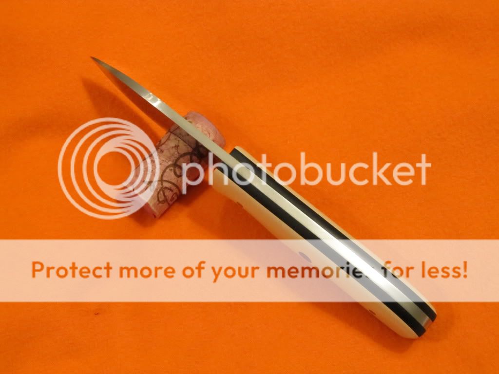

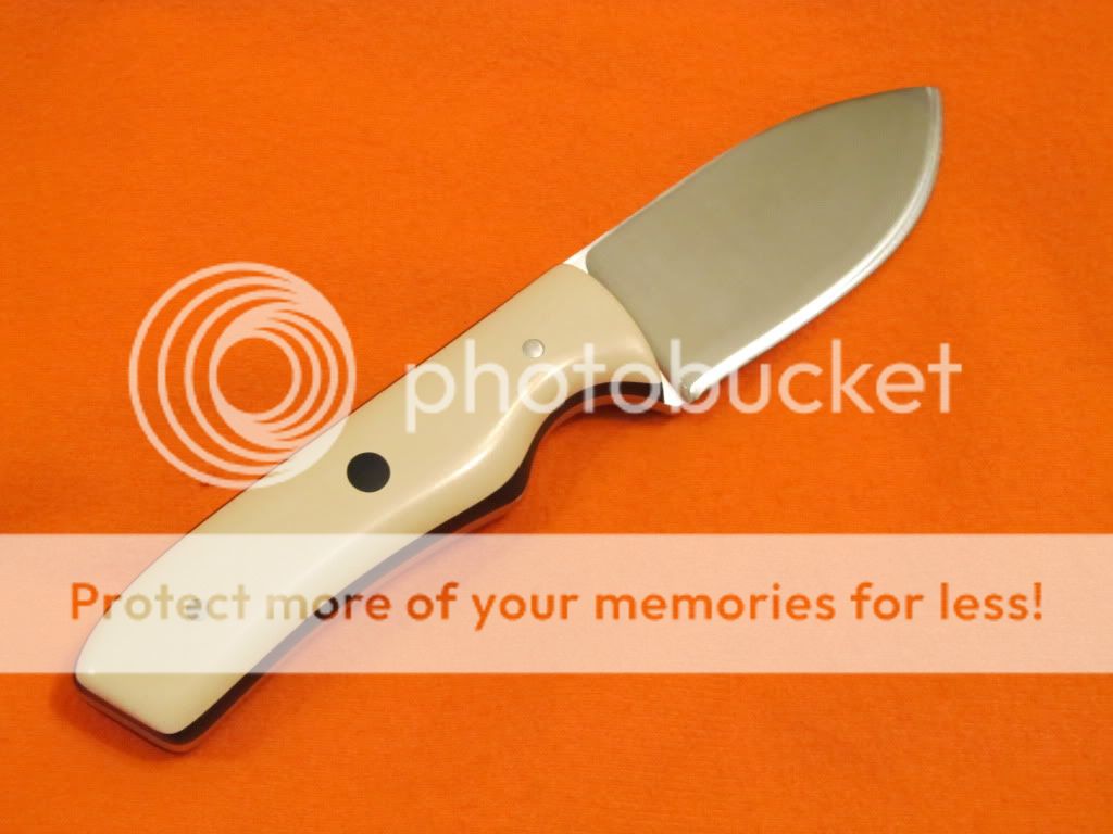

Hi Andy,
This is only the second knife since I met you at the blade show and would like some advice on comments on this knife. It is 154cm flat ground with a polished convexed edge (still needs some work, I rounded the point on the tip, but it is crazy sharp) The Handle is ivory micarta over black micarta with two 1/8" stainless pins and a 1/4" black pin. The blade is 2 7/8", the handle is 4" total 6 7/8". The finger grove was made from a 1" wheel and the other is from a 10" wheel.
Our Knifemaker Guild here in Saskatchewan has a table at a up coming gun show and this is the first knife I will show to the Public (I am working on a bigger on with the same design with bocote wood and a blue liner) So any comments are much appreciated.
