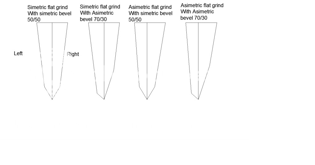

This one is the first, I made it with intent of being a nice little knife for cutting up leather. A nice small blade, with an almost squared off point for cutting down into the leather. You'll notice the bevels aren't the same on both sides. That was intentional, I like the look of a flat above the bevel, so I stopped the bevel partway on the side I put my mark, and on the other ran it all the way up to help thin down the blade more (not traditional I know, but I wanted to try it).

Good idea, both the knife design/usage and the grinding practice. I need to do more of that too. In the interest of that practice, why not try to do the same bevel grind on both sides with the same flats at the spine and the same shoulders at the ricasso? I understand your interest in variation, but that would be more of a challenge to accomplish and more in the spirit of developing your grinding skills. By-the-way, you might get a lot more of the type feedback you're looking for in the maker's forum. Those guys are there specifically for this type of dialog.
