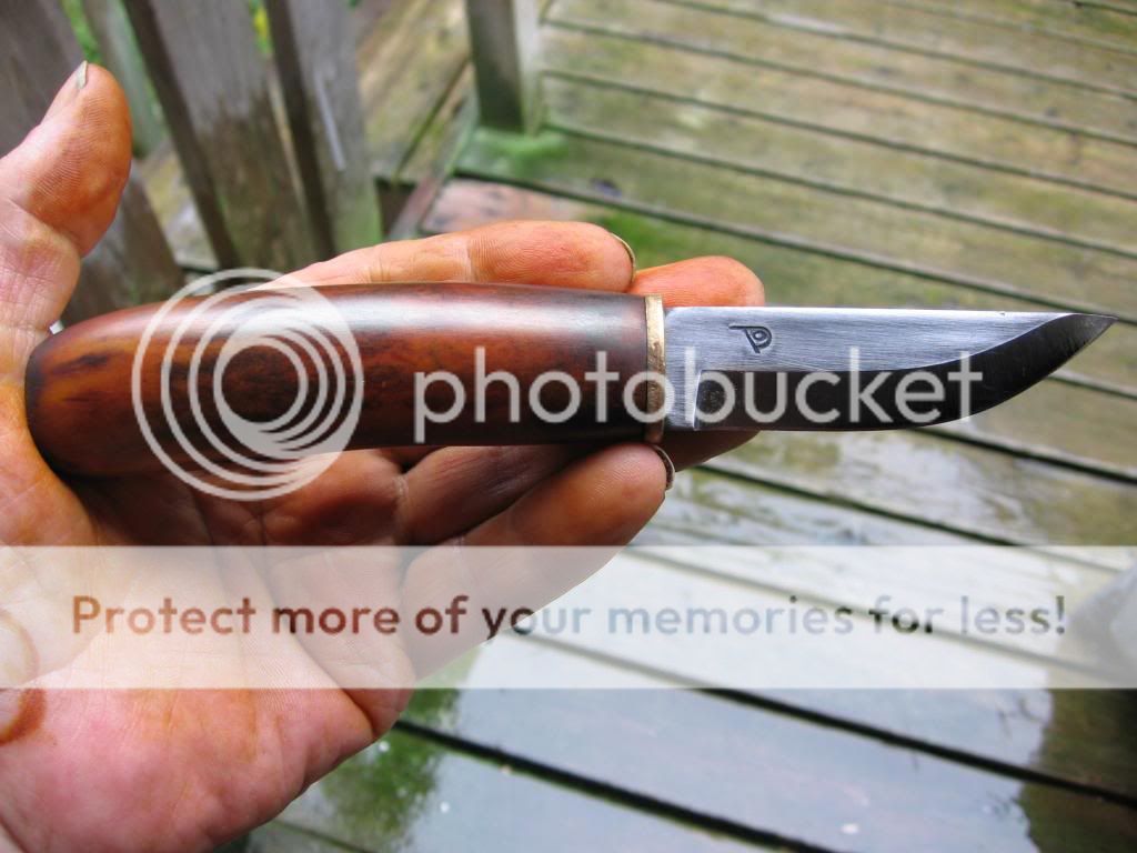

Hi BB,just wanted to show you what Fiebings leather dye can do (Results vary, depending on the bone and the age)
The opinel is Moose antler,very dry, sanded to white and dyed with dark brown oil and medium brown spirit based.
The fixed blade was pure white deer antler, very dry, and also dyed with the same dye colours.
As other have said, a light sanding before the dye and a polish sanding after it dries. I use coconut oil as a finish.
Have fun
Best regards
Robin
As you can see it also dyes human leather :D
