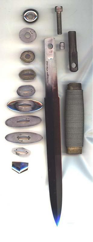

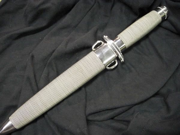

Wow, Tom Maringer's new dagger is awesome. After all these years he still has it. And if he's still just trying to get his mojo back then they'll only be getting better. The take down construction is fantastic. When it's all together you can't tell that there are that many separate pieces to the thing. Enjoy!!

Blade is D-2 steel. Toggle-tang takedown style. Handle and scabbard are stainless steel wire wrap over ash wood. All other exterior fittings are 304 stainless. Toggle is W-2 carbon steel. Signature, serial number, and date appears on the tang, parts are numbered and marked to show the correct assembly order and orientation. Stainless collars and scabbard tip are TIG weldments. The allen screw through the pommel snugs everything up securely.
I had stopped making knives for 12 years, but there were a few designs that have been kicking around in my head. It took me years to work out all the details of this toggle-tang construction, which is basically a modified Japanese tang style. Grinding is harder because now I have to use reading glasses to see anything close, so I just slow down and take more time. I had to raise the grinder up four inches to bring the wheel closer so I wouldn't get a crick in my back. I am interested in taking the sword-making techniques and applying them to slim blades like this. I also have a lot of new tools and materials in the shop from the years of doing other kinds of metalwork.

Glad to see you back at the bench. The dagger is very impressive indeed. I particularly like the "exploded" pic.

Isn't it refreshing to see a piece that is absolutely original in every way?
You could see that knife across a room and it would scream "Maringer".
