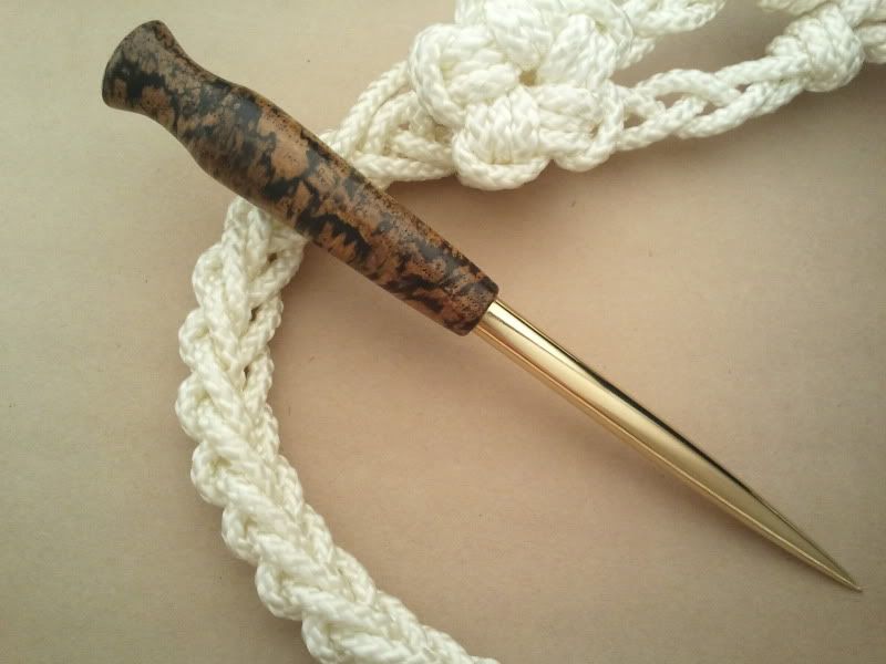

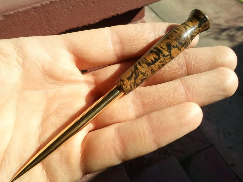

It's called a pricker, actually. Like a marlingspike, but smaller and with a handle. It is used specifically for knotting and fancy work. Great for drawing up complex knots or working with smaller cord, even in hand stitching things like chafing gear of canvas.
1/4" Brass shank, spalted pecan handle I collected the wood from a buddy who had a tree go down. Turned, shaped, polished and finished by me. Overall is 5.25" and shank is 2 7/8".
This is a gift for a fellow forumite, along with a more traditional working spike. The other spike is not finished yet.
Let me know what you think...
-Xander

Xander that is a great tool - beautiful and funtional! I love the pecan wth the polished brass - will that tarnish or is it lacquered?

Jmac30 - The brass is not lacquered, it can tarnish. Personally, I feel tarnish and patina are just earned character, but with a small amount of maintenance the high lustre finish can be maintained easily.
-X

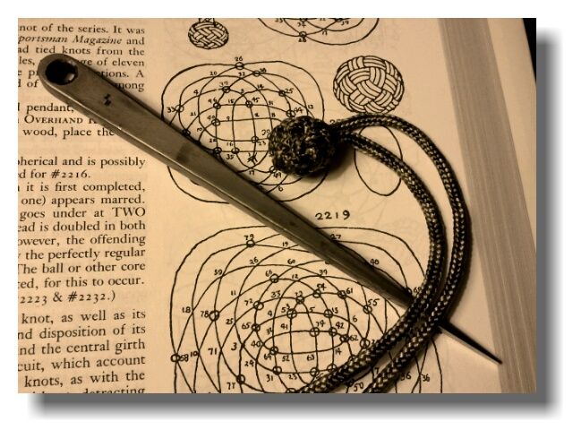

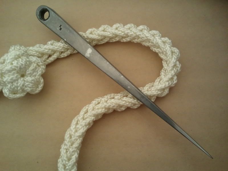

The tradional marlingspike is now finished. This will be going along with the pricker above to Gnarly.
1084
6" overall
1/4" x 1/2" at the eye

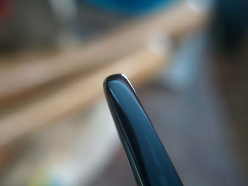

Ultra high polish at the tip
"Shop grade" quick and dirty 220 finish with vinegar patina
-Xander
